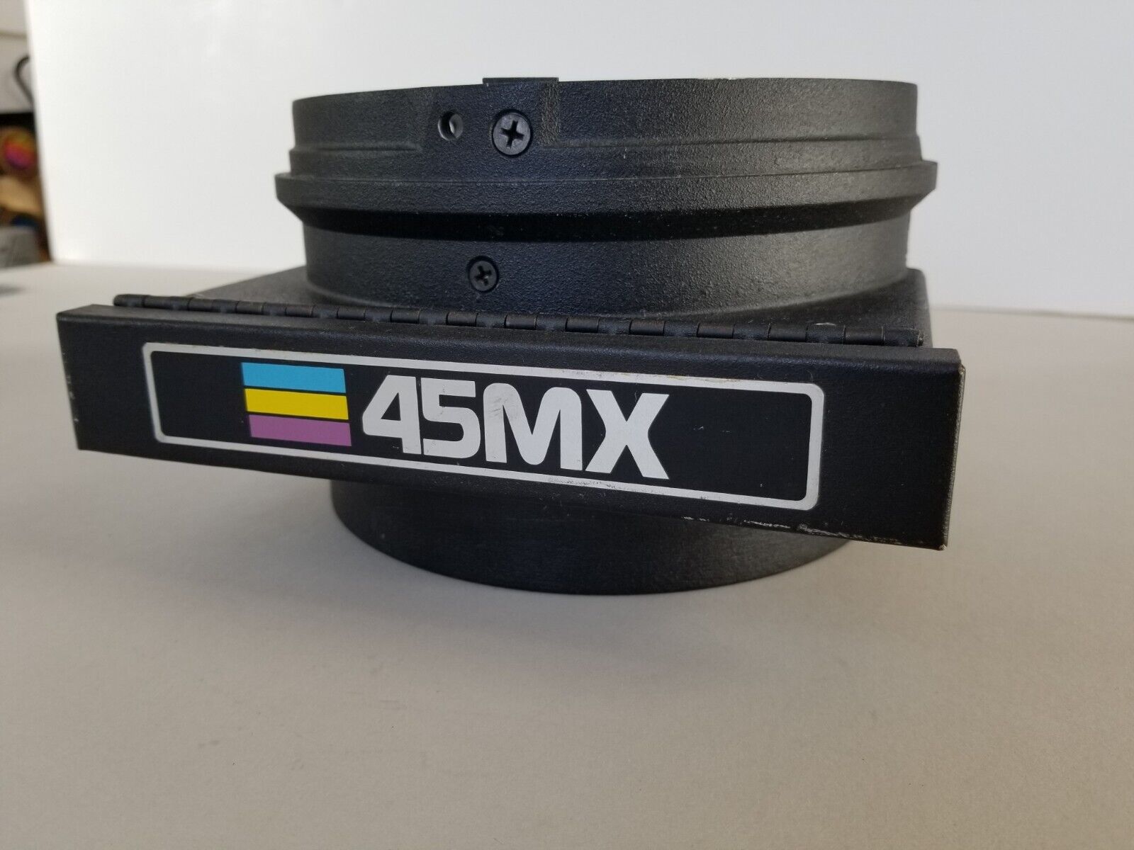

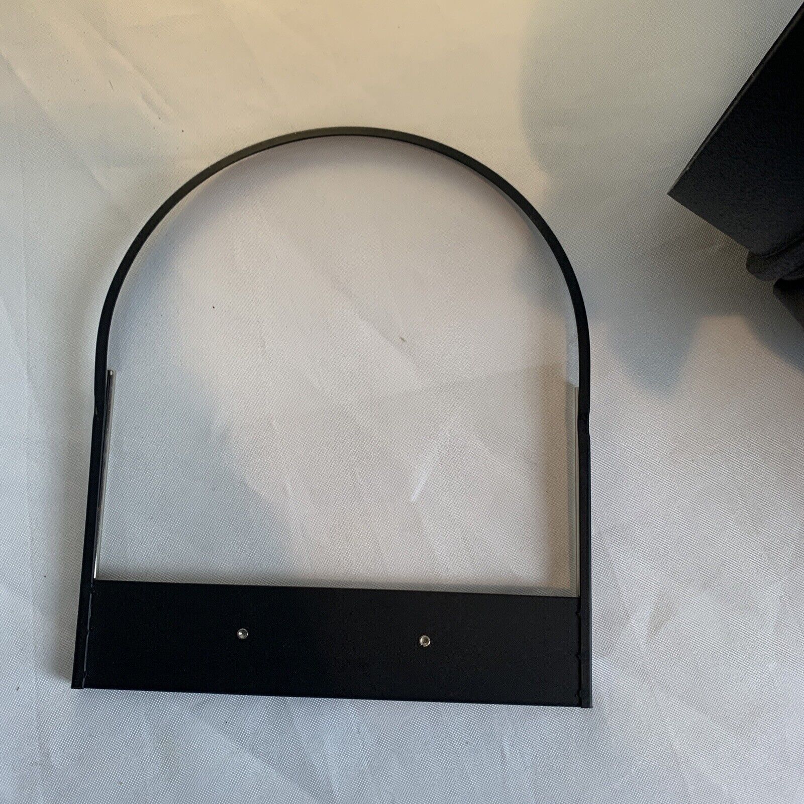

I know that this is a long shot but what I am looking for is the filter drawer for my Beseler MXR. When my enlarger was manufactured the filter drawer was an option that wasn't chosen. I have the condenser glass and lamp house but don't have the drawer needed for colour filters. Hopefully in Canada but Western Canada even better.

The filter drawer is part of the tubular casting for the condenser assembly. In your picture, you can see that the drawer and condenser tube are one casting. Does your casting have that drawer-portion? If not, you need a new condenser casting.

It doesn't as it is the older version when the drawer was an option on that enlarger, so I need the condenser casting. Someone may have that available in a collection of old Beseler parts as the one in the photo is availible on eBay but it is the whole thing (glass and light head) the seller wants $300 USD converted to Canadian $ is $411 which is out of my $$ range. I asked about just getting the casting that I need but nothing so far. Got a reply from the seller who told me "Dream on" .... So I guess I'm still looking😁

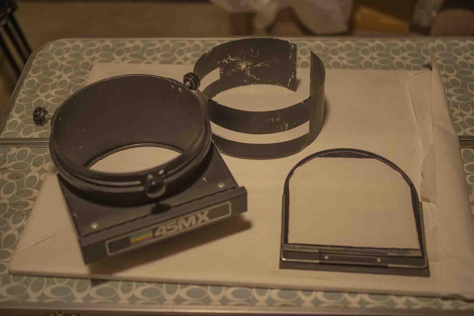

Well it looks like I have found exactly what I need from member thornhill (Derek Green) that is on it's way too me. The guy is fairly local so the shipping price was quite reasonable as the other places needed to ship it with the glass (unneeded) from Ontario so basically what I would have paid just for shipping is the amount I paid. Great having a website like this for film photographers that need certain parts that are not widely available. My 45 MXR should be fully functional properly soon.

Well everything has been installed and fits/works perfectly. Going to have to wait until I get less daylight for proper printing as I only have now is a bedroom/bathroom darkroom. Was doing a bit of Lith printing before that didn't need the use of contrast filters. When I used them before it was always a hassle getting them in a proper location that would work properly. When I did 35mm film I always used my 23C II but over the years I gave that away and increased my negative size to 4"x 5" so I only have my 45 MXR to use now.
