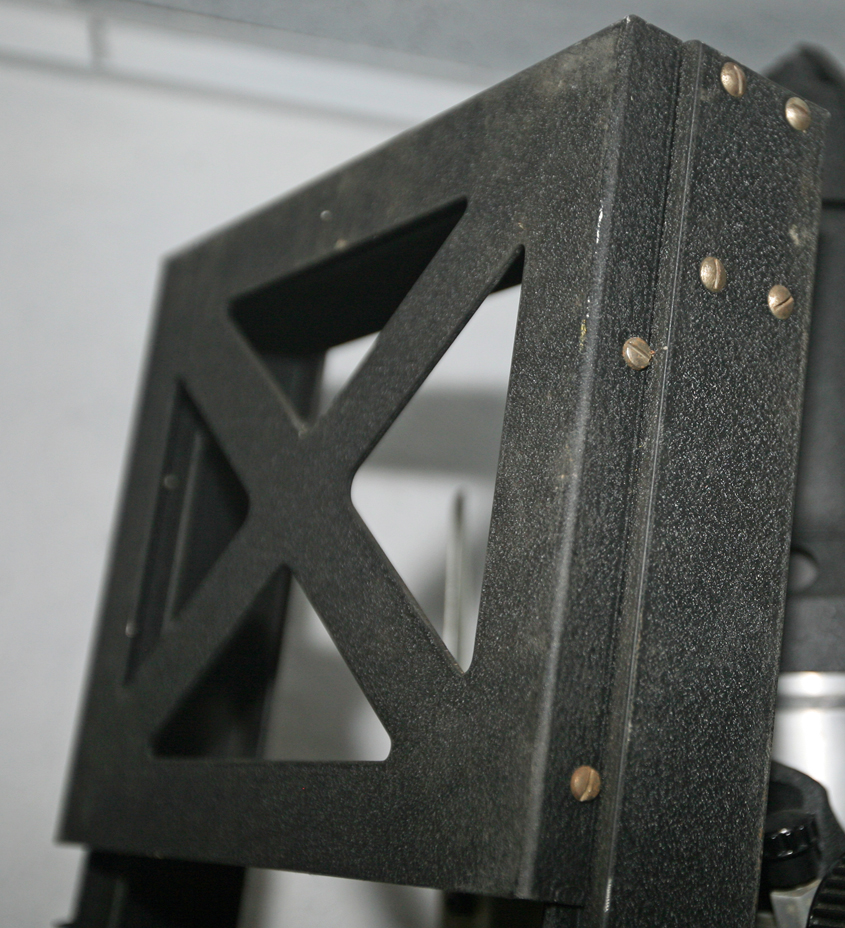

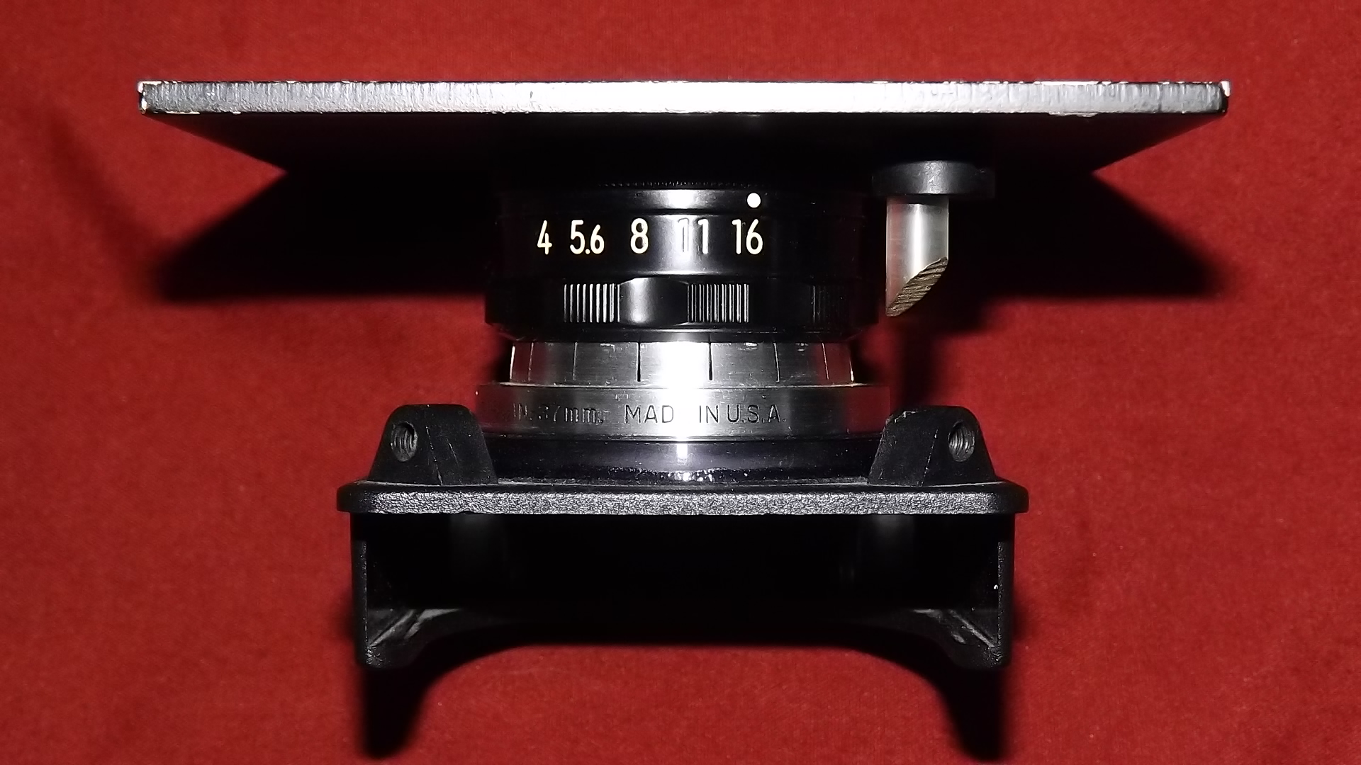

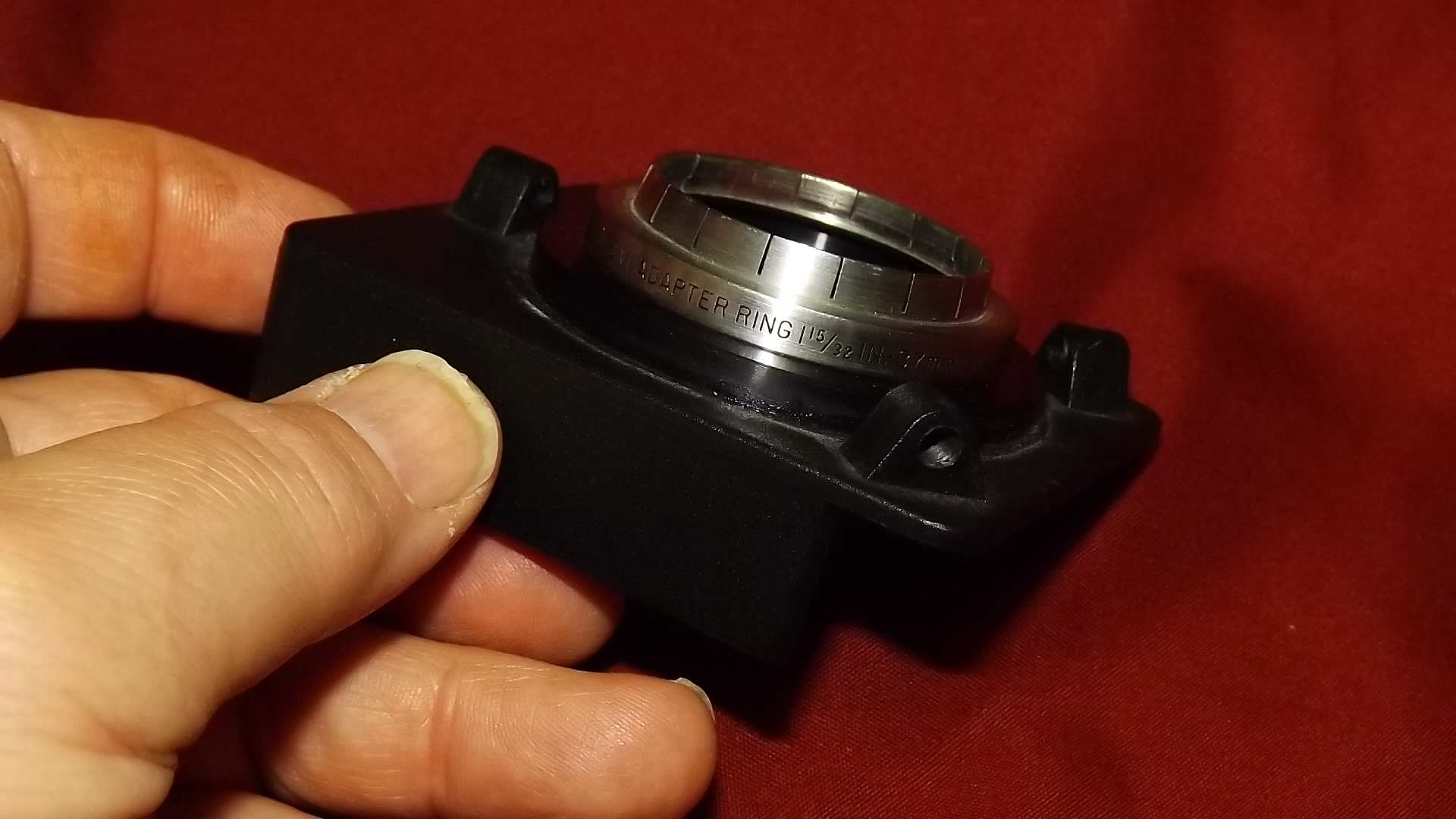

Carter-I noticed an "X" brace on the back of your 45H. Mine doesn't have that. Can you post a picture of it? I'm wondering if that was an optional item. And on the multi-contrast filters, what I did was epoxy a Series 6 retaining ring to a Kodak polycontrast under the lens filter holder and find Series 6 adapters for each of my enlarging lenses.

It really looks the same. If yours did have one the holes would be there for the screws. Here is a photograph of the back.

Carter, there are no holes on the column to mount that brace-I'm wondering if it was a factory option. Also, my 45H has the cross piece at the top of the column mounted with 1 screw on each side and the lower hole has a rivet in it.
I made the filter holder with a series 6 to 7 step-up ring and use whatever slip on series 6 filter holder that fits the front of the lens.

I used a series 6 to 7 step-up ring and glued it to the filter holder. Then I just use whatever size series 6 slip on filter holder that fits the lens I'm using.

Carter, I think I've figured it out. I bought my 45H used and it shows signs of being repainted. My thinking is that who ever repainted it forgot to reinstall the "X" brace. I do have the threaded holes for it-I checked last night.
