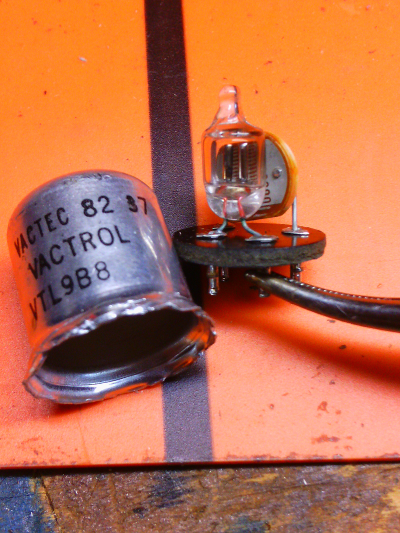

Same old story.....I bought my Fourth Color Head about 2 moths ago.
After about One Month of use, i start to notice (the now familiar) a lag when you push the timer. It takes a second or two for the light to come on. It varies. Some times the light hits right away, other times there is a lag...then it gets worse...then it will not light at all.

Vactrol CMOOR sent me, the light source in the vactrol is a neon mini bulb.... pic below.
CMoor, have you cleaned all the contacts in the head to the board and check the bulb contacts, and maybe any relays in the system need cleaning? Try hooking up a regular lamp to your timer to make sure it is working?... use another timer to reproduce the problem?
Odd you have had so many failures. Many people never see this problem in a life time... so far Ive only heard of 3 people with this complaint. they just replace the board and never see any problems after that. Neon bulbs like these are used in old florescent light starters... maybe strip one to get the bulbt?

Chip, I'm the one that sent you the "new", never used, 25 year old Vactrol optos. I have fixed 3 45s heads by replacing that one opto coupler. Never had any problems with any of them for years. I do know one thing, if you want a repair on these things done right. I highly recommend Kevin Brown at KHB Graphix in Mississauga, Ontario Canada. He's the man with all things Beseler. There are modern, more reliable, opto isolator options. I found a guy 15 years ago, he sold obsolete electronic parts, out of a shop, on Long Island. I paid 200 bucks for 10 of those little buggers . These are the original part that Beseler used back in the day.

Every single one of the old ones eventually will fail like this. Timers have nothing to do with it.

didn't we find a link to those neon bulbs? get the bulbs and repair the vactrols? its a simple solder job.
