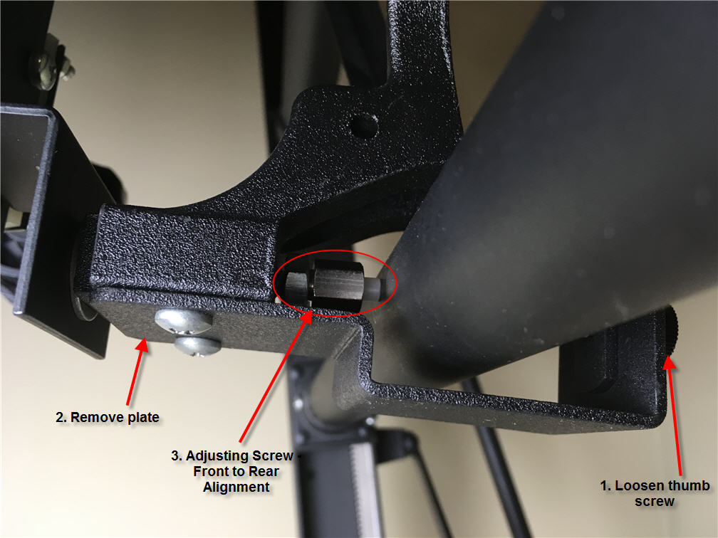

I do not have my manual in front of me and do not know which item numbers are given to these parts, however, the attached picture identifies how i adjust the front-to-rear alignment on my Beseler 45MXT. Hope this helps.
