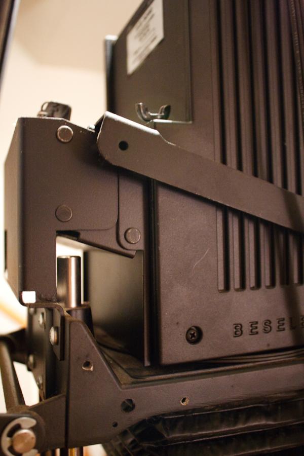

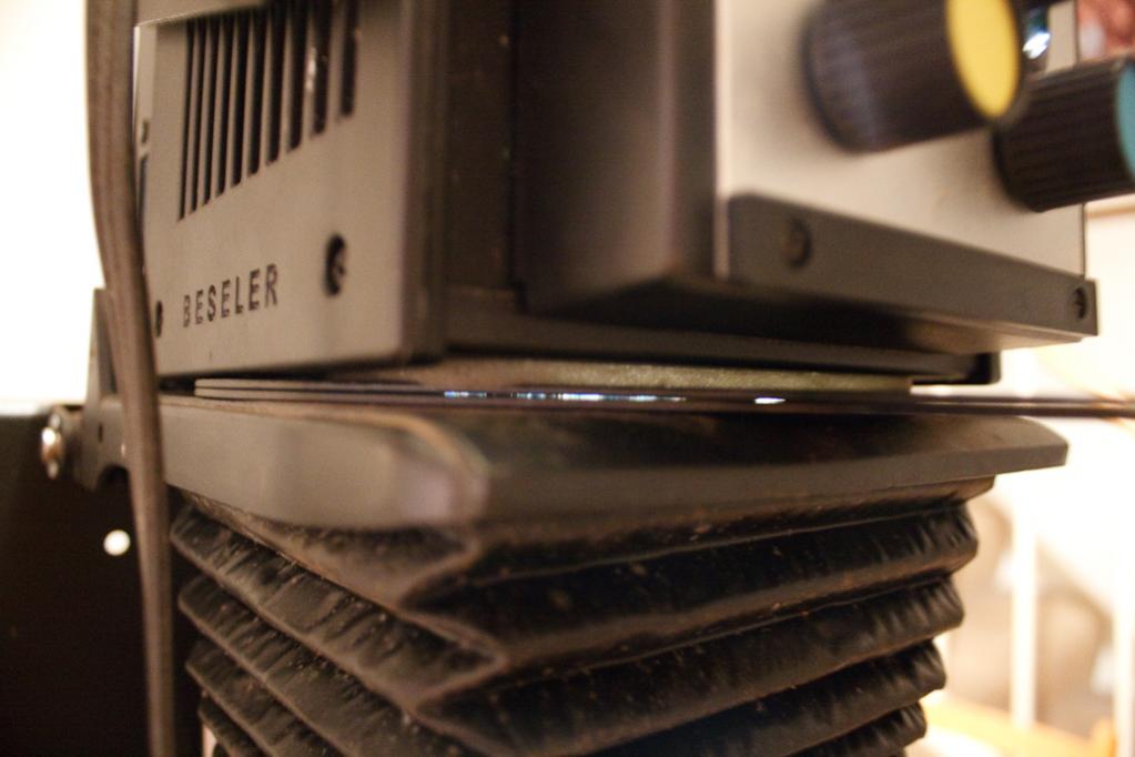

Here's the part about the head not sitting level.
attachment.php
attachment.php

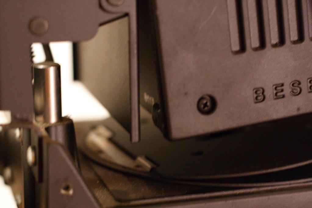

Here is what is causing it:
attachment.php
That little tab is preventing the head from sitting flush with that plate. If its ok, I could dremel a pair of notches into the corners of the plate to make clearance. What do you guys think?

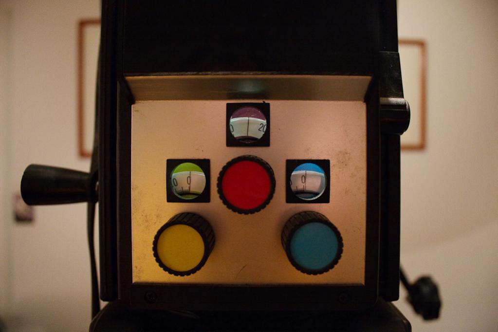

Here's the dial:
attachment.php
The inner workings are rather complicated, i'd really like an exploded view diagram or something before I start digging in to fix this. I can't even find a manual for this thing anywhere though.
I appreciate any help you guys can give. Thanks.
