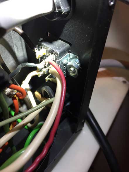

Inside view of external stabilized power supply for the Dual Dichro (non-S version). The transformer/circuit board and rear view of enlarger head socket are shown. The two contacts on the top of the connector are where a true RMS AC voltmeter would be connected for adjusting the output voltage to the nominal 24 vac needed by the EJL halogen lamp. There is a pot on the board for voltage adjustment. The lamp must be connected and powered when adjusting the voltage.
Obviously, hazardous voltages are everywhere with the case open, power applied and interlocks bypassed. Be very careful!!
