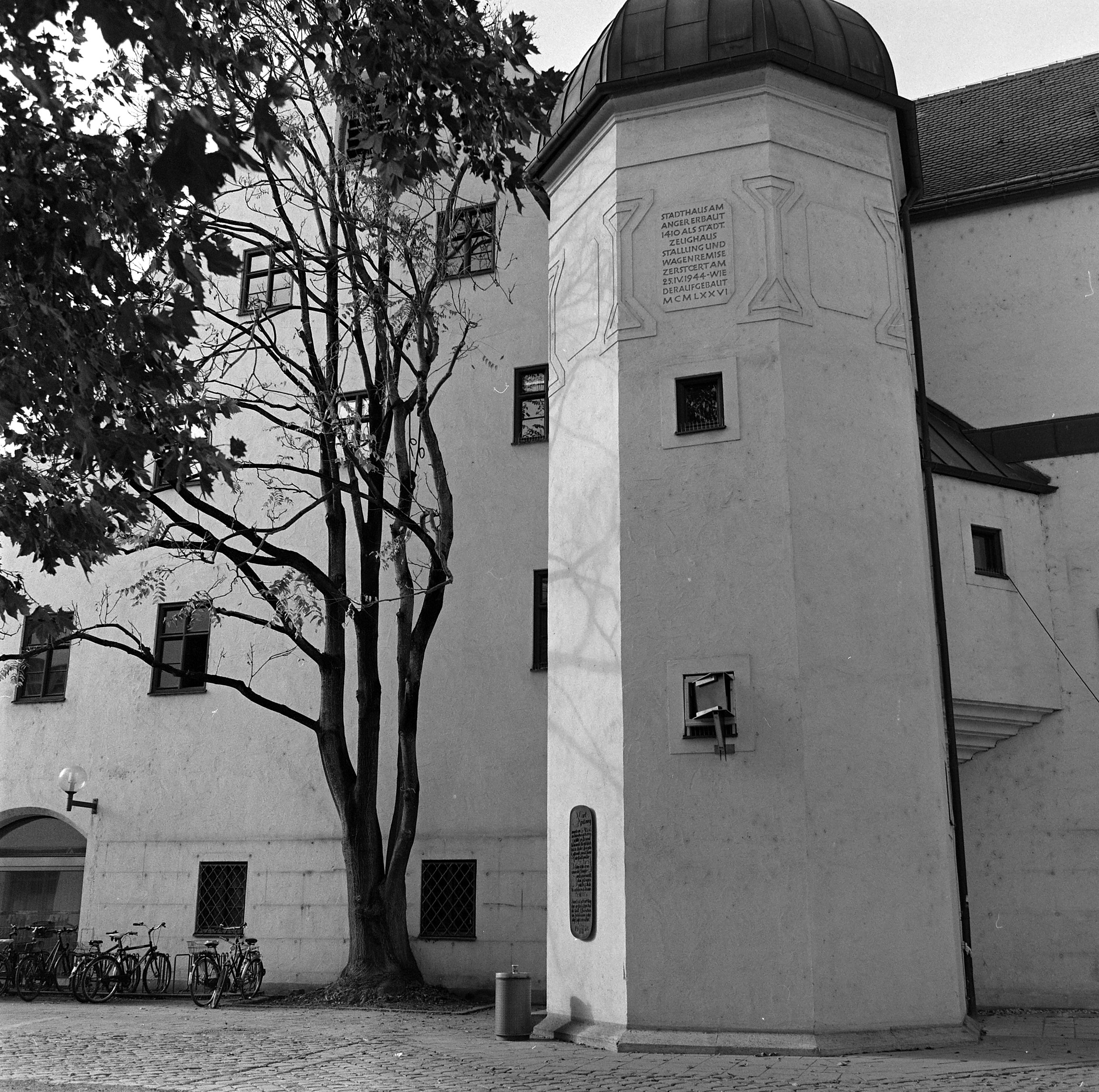

Here is an example of Pancro400 in 6x6 format, shot at around 300 (i.e. + 1/2 stop from the meter reading), developed in BER49, no processing/curve adjustment etc applied after scanning:
