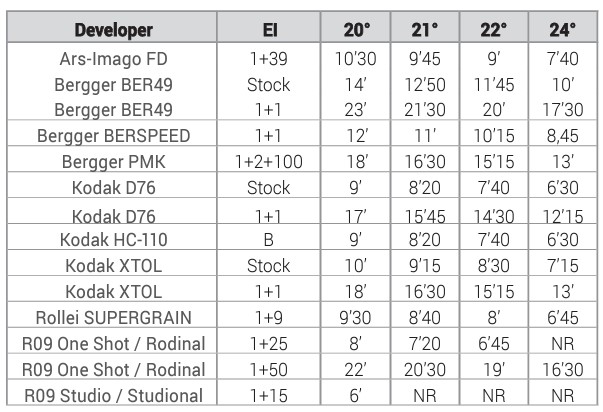

I'm curious, are you looking for something other developers cant achieve with Pancro 400?
I like the film a lot, but pretty much just stick to the recommended dev choices so far.
I cant even find starting times for stuff like LegacyPro Mic-X (Microdol X) etc..
Thanks for sharing :smile:
