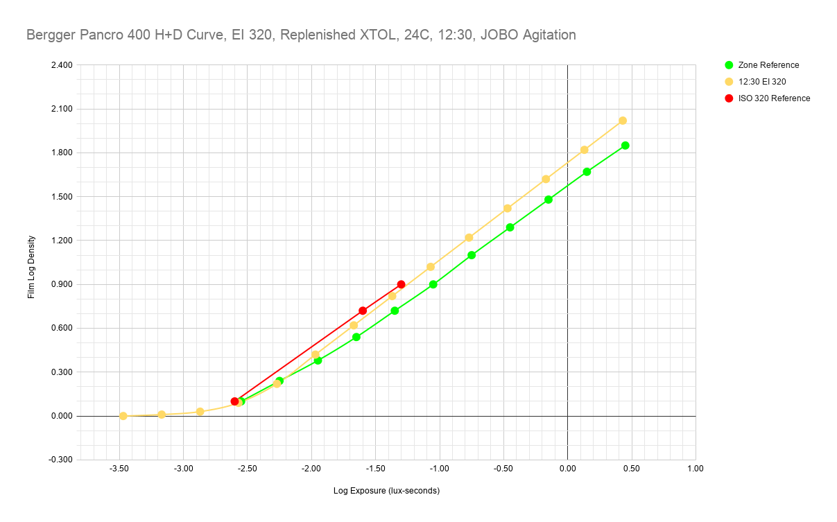

For reference, and if anybody wants to discuss.
I've made these exposures as carefully as I could and eliminated as many variables as I realistically could. While it is not scientific, and certainly not up to ISO or probably manufacturer standards, it is as accurate as I can make it with what I have available to me, and certainly accurate enough that I thought it would be share-worthy.
Each of the curves is from film base plus fog up to a correctly exposed 18 percent grey card in full stop increments using a studio strobe, and transmission rated lens set to infinity focus. The strobe was incident metered to 1/10 stop and varies less than +- 0.1 stops shot to shot. The intensity of the light to the film plane was controlled with the lens aperture, so once the strobe power was set, it did not change for the duration of the exposures. The 18 percent grey card filled the frame so there shouldn't be any flare.
The densities were measured with an X-Rite Densitometer.
Bergger Pancro 400 H+D Curve, EI 320, Replenished XTOL, 24C, 12_30, JOBO Agitation.png
That is a fantastically straight characteristic curve, AND, at ISO contrast it hits ISO 320 with a zone 1 density of 0.09 and 4 stops up from that at 0.82 density. I imagine that zone contrast would net an extra ~2/3 of a stop exposure and a dev time of about 10 minutes. Just wonderful.

I’ve also run it for 13:45 at EI 320. That puts zone 1 right at 0.1 and zone 5 at 0.93. 15 minutes at 320 gives 0.11 and 0.98. 17:30 at 400 gives 0.07 and 0.98 and 20 minutes at 400 gives 0.1 and 1.1 with zone 4 at 0.79, so ~20 minutes looks to be a reasonable push time if you want to shoot it at 640-800.

Thank you Adrian for this time with XTol. The 1:1 time is quite long. Are you using 24C because you happen to be using a Super Sidekick? Or a Jobo? Normally I stick to 20C but I'm not dogmattic about it.

I standardized on 24C for two reasons: 1) it’s faster and time is money, and 2) during the warmer months of the year the ambient air and water tends to hover closer to 22C, so in the interest of having just one time year round, I just make it 24C.
