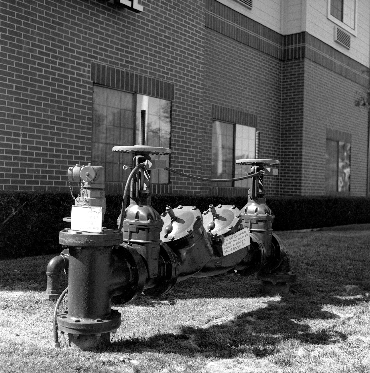

I just shot and developed my first roll of Bergger in 120 in my Rolleiflex
I developed it in HC110 Dil. B 9 mins.
I like they way most came out but I do have an issue with the film curling, end to end and not side to side but other than that it looks good
I will need to shoot a few more and try some other developers to know for sure
Here are a couple that came out pretty good, for me :smile:

I agree on the curling. These are out of the GF670 (6x6), xtol stock. Coolscan 8000 to raw, colorperfect virtual grade 2.
JWMster
Jan 31, 2017
1,160
Annapolis, MD
Scott: Like the "Winery" shot in particular for the light shadows. Nice work! Yep: Bergger curls!
