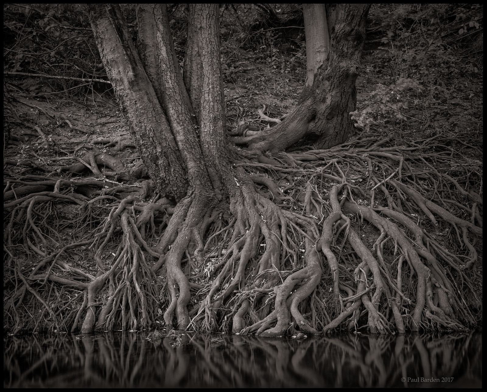

Yesterday I had an opportunity to shoot in one of my favorite spots on the river under cloudy conditions, and I used 8X10 inch Bergger Pancro400, with the Deardorff (and Schneider Symmar-S 240mm lens). This negative was processed in Rodinal 1:25 for 7 minutes (slight pull). I felt I was having "a Clyde Butcher Moment", standing chest deep (wearing waders) in the river with my Deardoff!

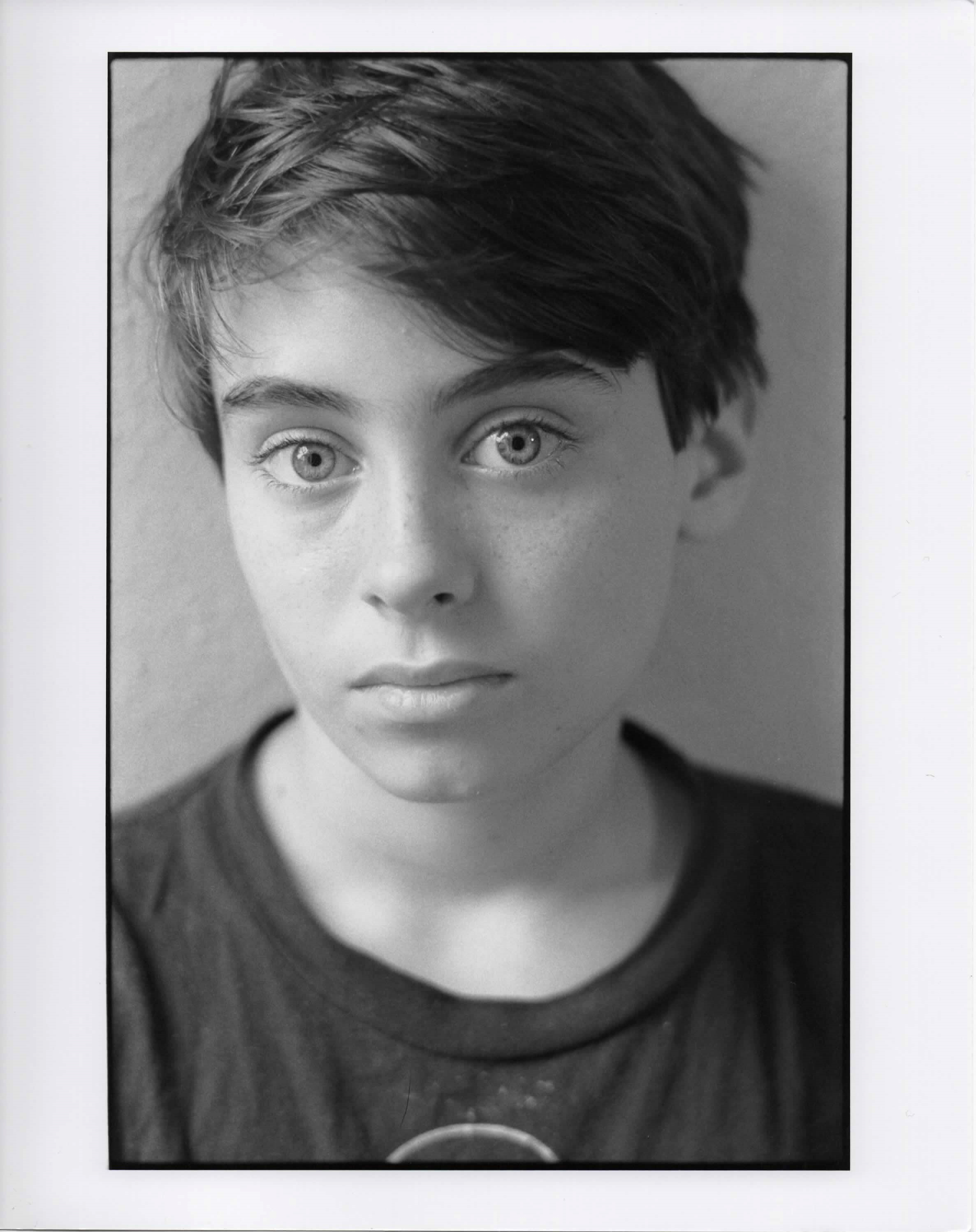

Here's a scan from a recent print. Taken on Bergger Pancro400 at EI400 with a Minolta SRT 101, a 50 mm lens at F/2, developed in XTOL (stock) for 10 min. at 68F. The paper is Ilford Multigrade IV RC 8x10, a full-frame print from the negative. Developed in Ilford Multigrade Developer. My flatbed scanner is Epson XP-430, an all-in-one printer/scanner.

An ongoing series of Alder Root studies, shot on 8X10 Bergger Pancro 400 (with Deardorff)
Technical:
- lens used was my Schneider Symmar-S 240
- as others have mentioned the base+fog is higher than most emulsions, but that isn't a problem for me.
- Exposure was calculated to be 1:45 @ f45 based on an initial estimate of 22 seconds, and I applied the reciprocity factor for HP5, which I find works well enough (we apparently don't have reciprocity information about Pancro 400) I consider this negative to be an ideal exposure, so HP5's reciprocity values are workable, in case you wondered.
- Processed in Rodinal 1:50 for 20 minutes (2 minutes less than Bergger's suggested starting point. I did this to limit contrast buildup from long exposure/reciprocity.
- minimal adjustments for contrast done in Lightroom, slight vignette applied
