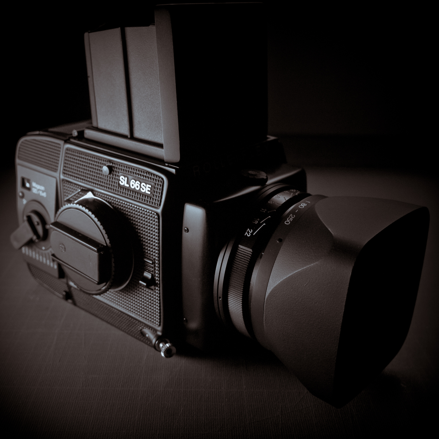

and then take one step beyond and get yourself an SE and you're really there !
https://www.flickr.com/photos/77846450@N00/8079898153/in/set-72157625911025516
Indeed.
