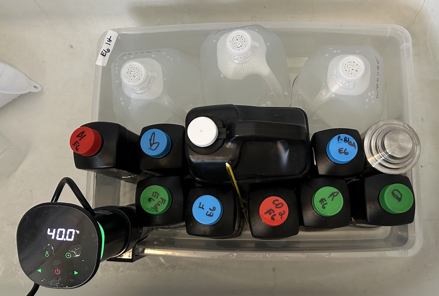

FWIW, this was how I did the "preheat" with my kit.
Nothing too crazy here except that I had enough stuff in my water bath that I could just wedge the stainless tank in and not have it float off. I also kept it in here during processing when not agitating, especially as over 6.5 minutes the temperature in a stainless tank can drop 2-3 degrees sitting out on the counter(actual measurements I've made for steps where the lid can be off).
I picked up a few of these Nikor tanks with the larger-than-normal pour opening in a big lot on Ebay last month. They're a treat in the 900mL size because they can fill and empty about twice as fast as most of the other SS tanks I've used. I worry less about it for E6, but 3:15 for C41 makes pour times super important.
I do something similar but like to keep a little more space between the bottles so that the water flows around a little easier. Helps everything to get up to temperature slightly faster, although in the end, the net result is the same. I also try to keep the developer close to the thermostate in the assumption that temperature will controlled the best in that spot. Final rinse etc. are less critical so can be kept more remotely.
I'm using a similar contraption with a NOVA 300W heater and an aquarium water pump to promote water flow around the bottles:
I usually keep this one a bit less full, but was also planning on mixing some C41 so had more bottles than are strictly required(especially the 3 of distilled water). I set this one up at about 7:00AM with 6 gallon bottles of distilled water, and kept it going through the day. I'll add too that the big 5L bottle in the center is full of tap water-it's really handy to have some already at temperature for washes-I know washing isn't super temperature critical but I also want to avoid a big swing one way or another.
I may still take the lid meant to fit this tub and cut holes in it for the bottles(in the vein of a Jobo tray) as one benefit of having it full is it keeps them from floating around too much.
In general, though, I agree that better water circulation is definitely advantageous, and I tend to put the ones that need the best temperature control closest as well. You'll note that the E6 first developer is directly next to it, which of course is the most critical one of the whole process. I also want the color developer there-I know it goes to completion so extending time isn't an issue, but I've seen C41 tests at lower temperatures that showed some color shift/crossover can happen at the wrong temperature even if density is good. With that said, I don't know if say 38º vs 39º is a big deal on it-the tests I've seen on C41 kits don't seem to have issues until you get down into the 30º range(as a side note, I wish you could safely run C41 at a lower temperature, as I'd love to be able to extend development to ~5 minutes, but I'm not going to experiment with that).
For this particular photo, I'd actually noticed that my CD had gone up close to 40º so I'd shuffled it away to cool it off a bit. This isn't a perfect solution(if such a thing exists) and the thermostat is sat at 40º because I've found that even with an hour of equilibrium time, that tends to give me 39º in the bottles. Otherwise, though, for this cheap unit I've been impressed by its temperature control. Set to 40.0º, the water bath will measure +/-.2º, and even in the far corner it will still usually hold 39º.
