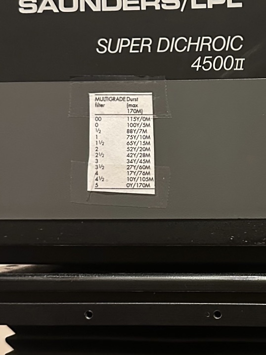

Looks to be spot on in terms of exposure, with a diffusion light source the contrast will be well controlled and the gain will not be noticeable, with Rodinal good edge sharpness. I like the shot. What paper are you going to use?
I’m not sure. The previous owner had this taped to the enlarger head. I assume these settings can work with most VC papers. I’d like to print on RC for contact sheets and test prints, and on FB for archival prints. I’m open to suggestions.
I use Multitone for contact sheets and first generation work prints, then move on Foma RC and FB for final prints. ILford is a very good paper, I just prefer the tones of Foma.You may want to experiment with split grade printing. It is a bit more work, as you need to make 2 test strips one at max yellow, then a second at max meginta, divide the time for each in half for the final print which is exposed again with max yellow and max meginta. I find the tech useful as it reduces the need for buring and dodging. I think ILford has a pretty good online video.
