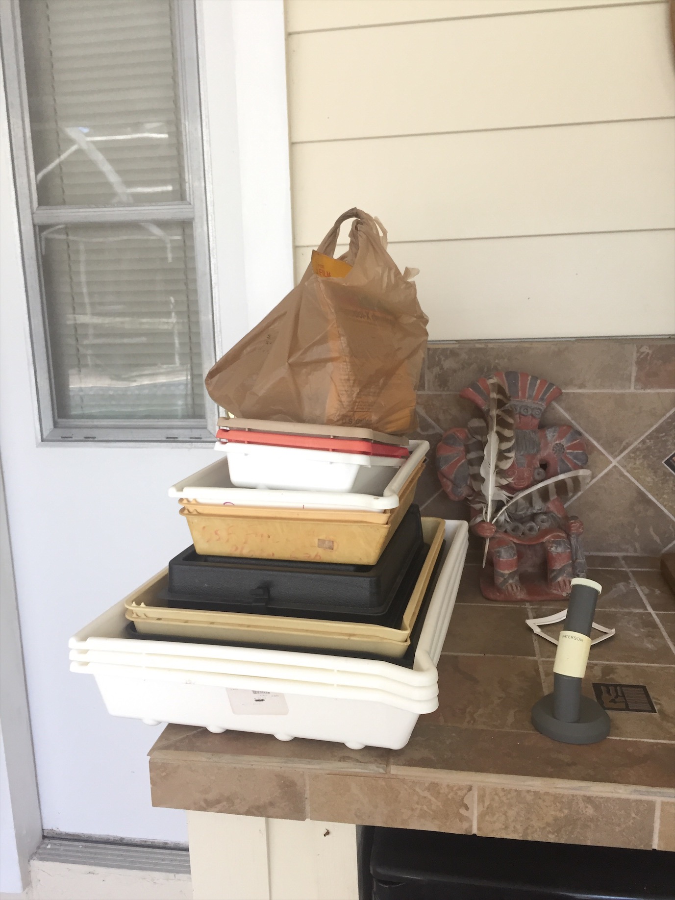

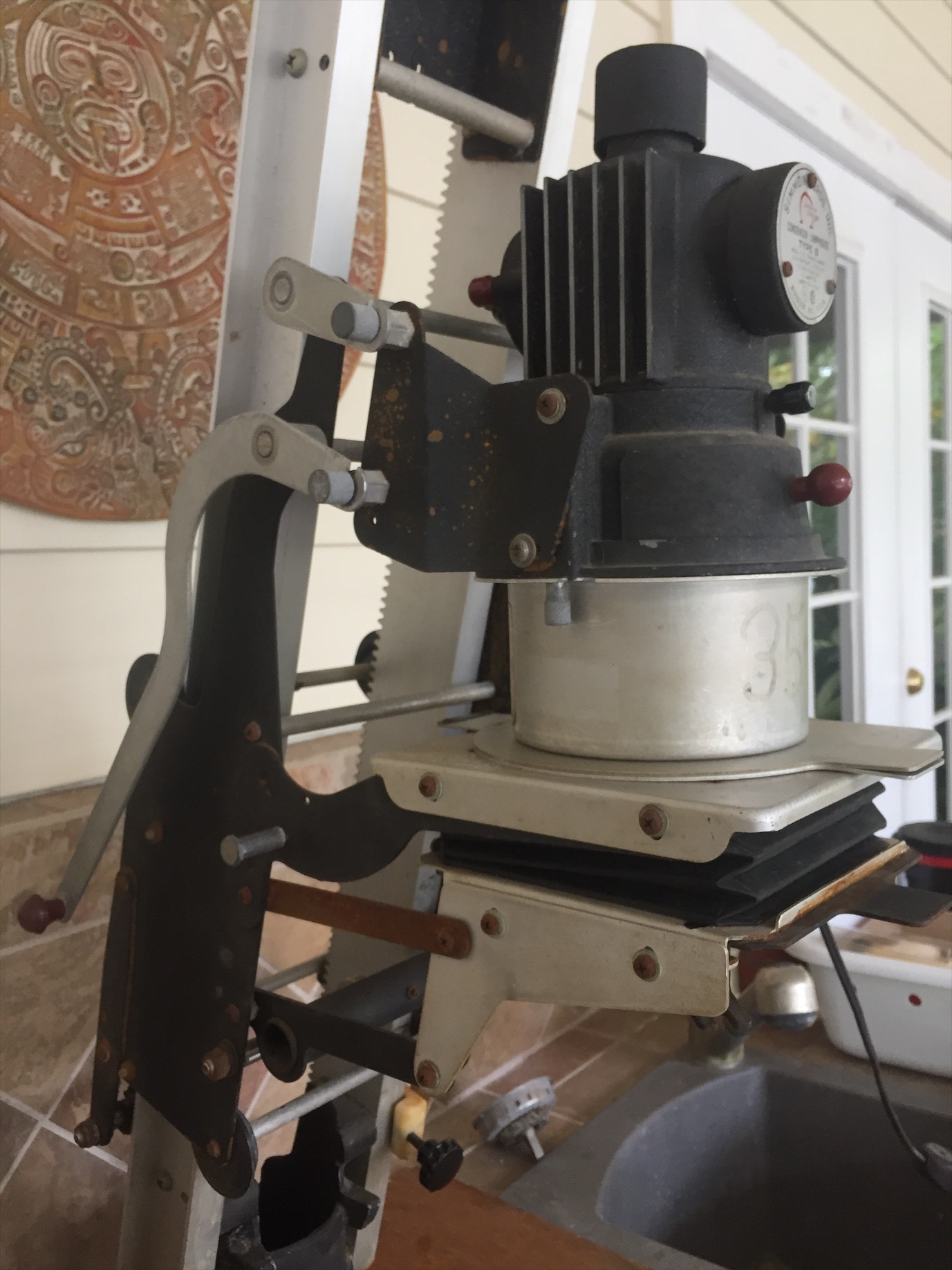

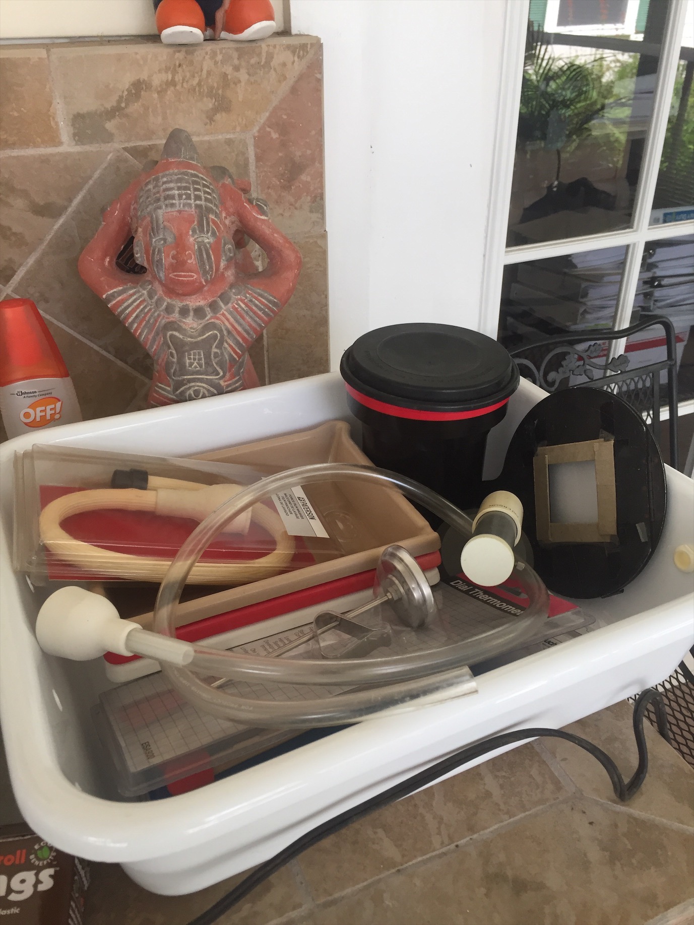

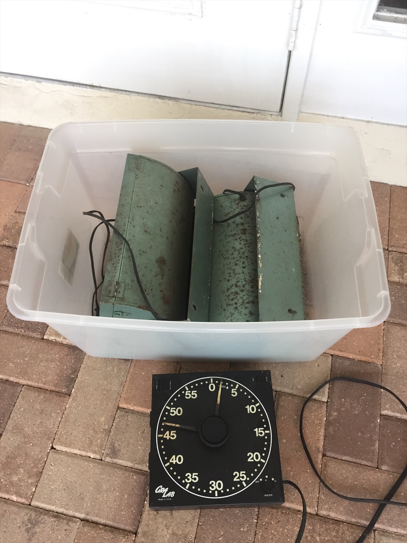

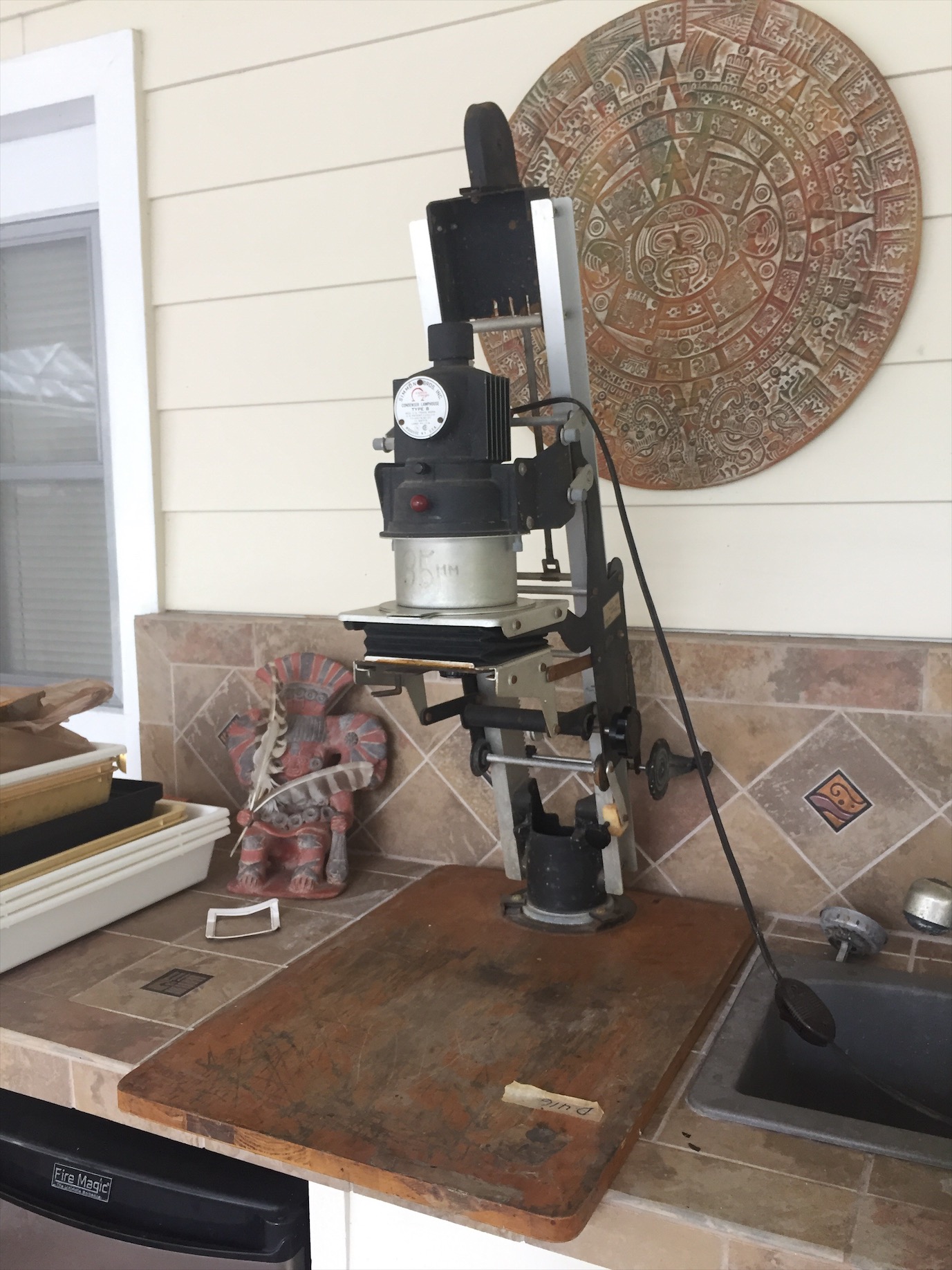

Just picked up my first darkroom setup and now all I’m lacking are chemicals.
The Omega B-8 included is Very dirty and has a fair bit of rust but I’ll see if I can get that cleaned up this evening. It is fully functional except for the gear used to lift it up and down. It can still be done manually but I’ll see if I can fix that gear to make it more convenient.
It also included 3x each of trays for 5x7, 8x10, 11x14 and 16x20, a paper safe, a bunch of old developer that I won’t even think about using, Paterson 2 roll tank, grain focuser, thermometer, tongs, 2 safelights, and a Gralab 300 timer.
I was able to get it all for $40. So maybe I’ll be able to start my Darkroom for under $100 including chemicals!
If anyone has any advice on cleaning up that enlarger, fire away.

Looks like there is still lots of fun in that one!
If any of the developer is print developer, it can't hurt to try it.
Go to the hardware store and show the photos to someone who might know about rust cleaners.
And carefully inspect the wiring for damage. That advice isn't particular in any way to enlargers!

The enlarger has a sticker on it from USF so it definitely got its fair share of use (and abuse?). I'm hoping I can get that crank working but, like I said, I can still raise and lower it manually.

RE: the "broken crank handle, for raising and lowering the enlarger; there's an Allen screw
that holds it to the shaft; maybe it's loose, or missing. I had the same problem with mine when I first bought it. BTW, make sure the set screw, that can be used to tighten the enlarger carriage on the upright girder, is loosened when you raise or lower it.
