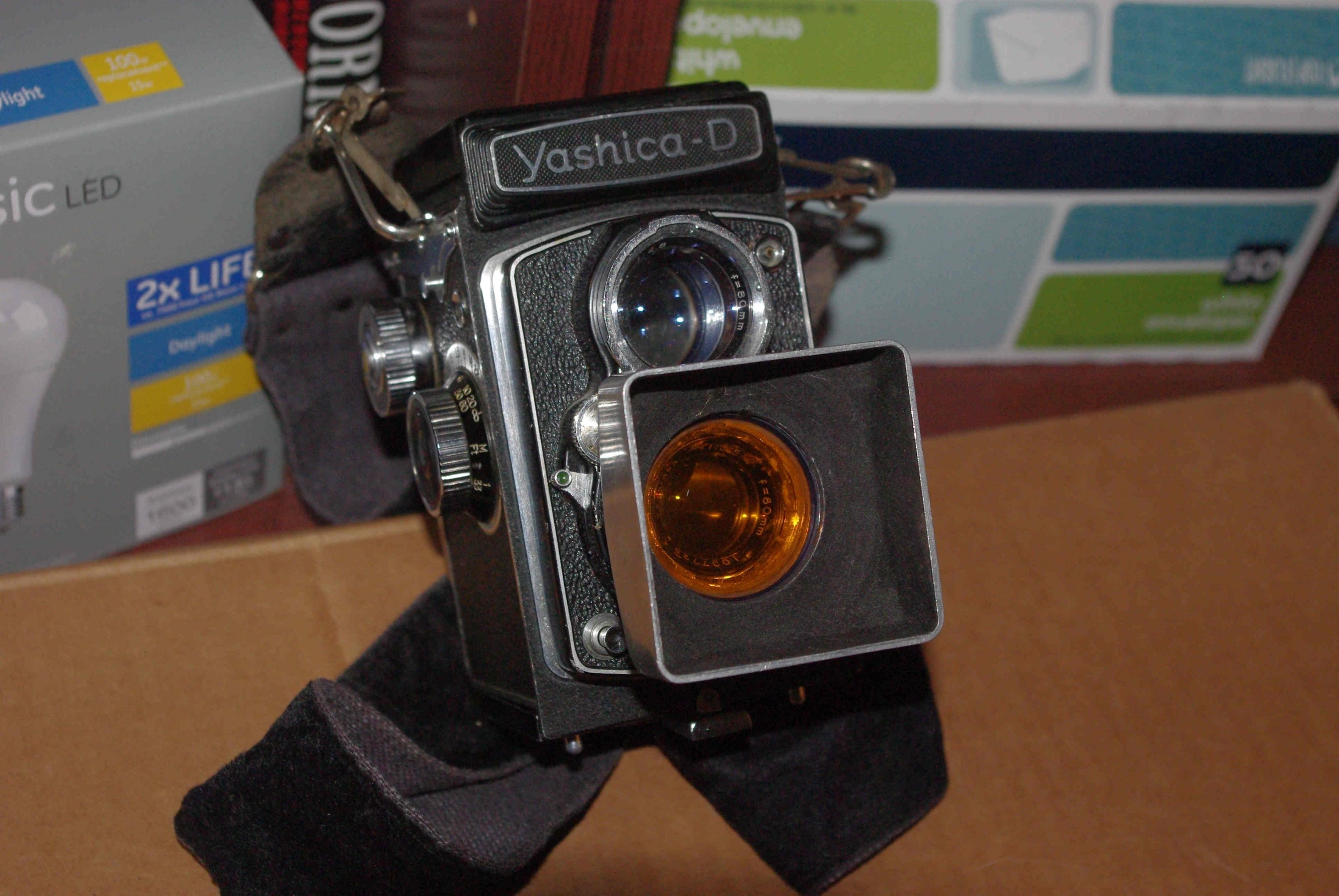

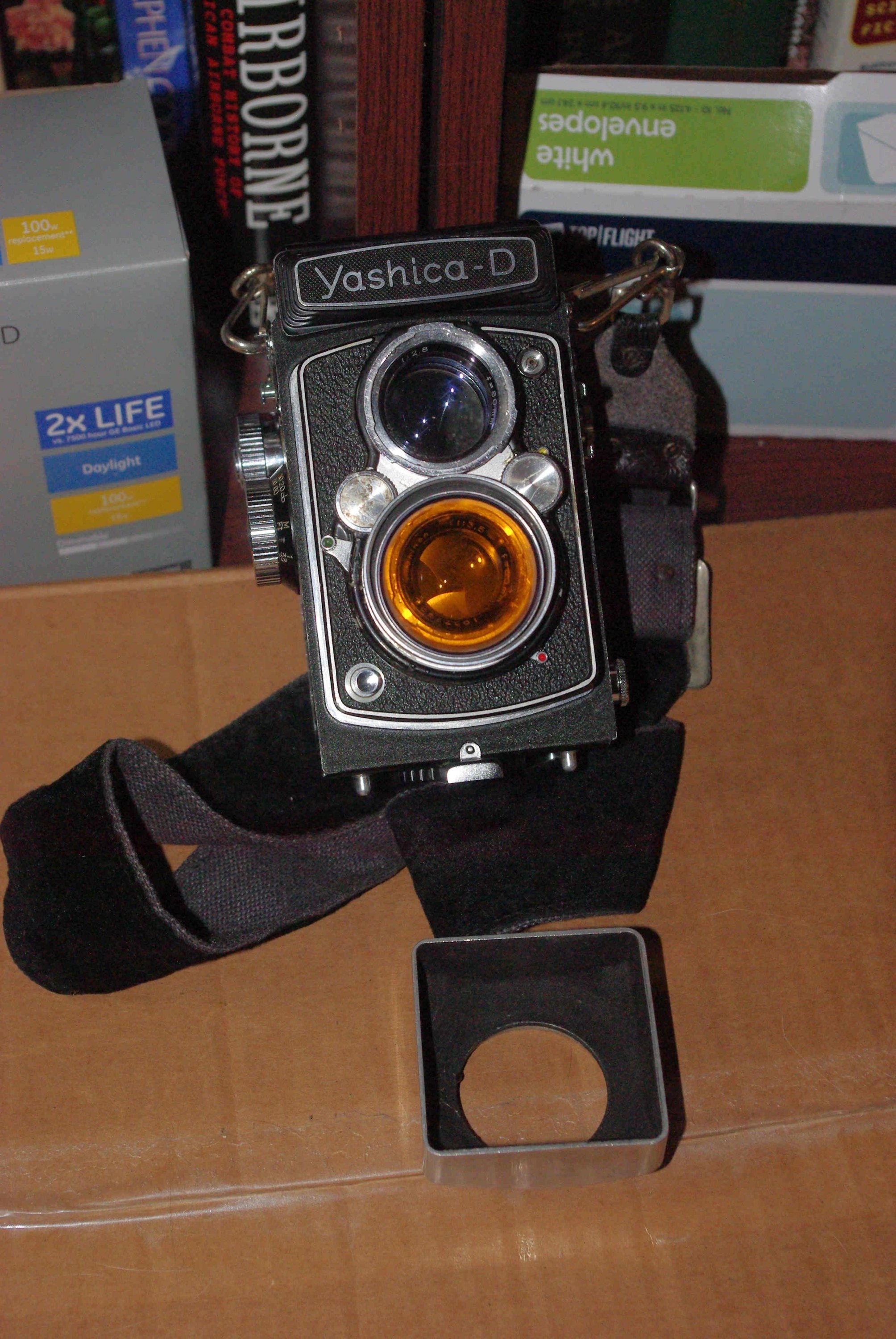

I've only found series styles filter used, Ebay, I use a Series VI adaptor on my Yashica, it has flanges that I bent out a little and it slips over the taking lens, I can use it with a filter and retaining ring or a lens hood that replaces the retaining ring.
