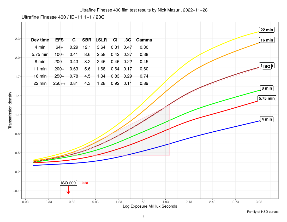

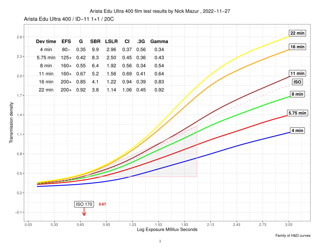

Here are the curve families for Arista Edu Ultra 400 and Ultrafine Finesse 400.
aristaEduUltra400Combinedraw_dataPlots.pdfabsolute_final.pngultrafineFinesse400Combinedraw_dataPlots.pdfabsolute_final.png

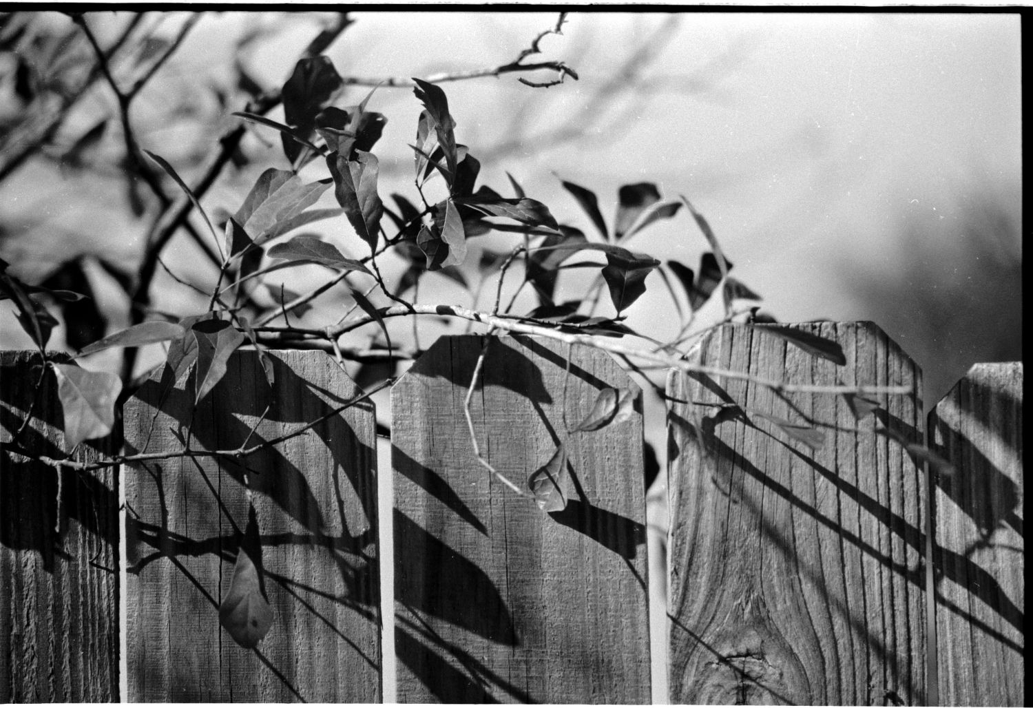

And here are a couple of interesting bits. First, I found this odd-looking flaw in most of the photographs from the Ultrafine Finesse 400 roll. It's a thin, dark, irregular line across the film (lengthwise). You can see it near the top right corner of the flag. Have you guys come across this kind of thing before? This doesn't look like a typical scratch that a user or camera can cause.

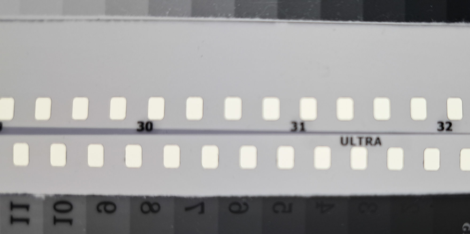

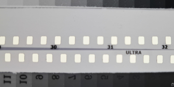

Finally, here's an image of the edge markings of the Arista Edu Ultra 400. It's the only film in this group with any edge markings.

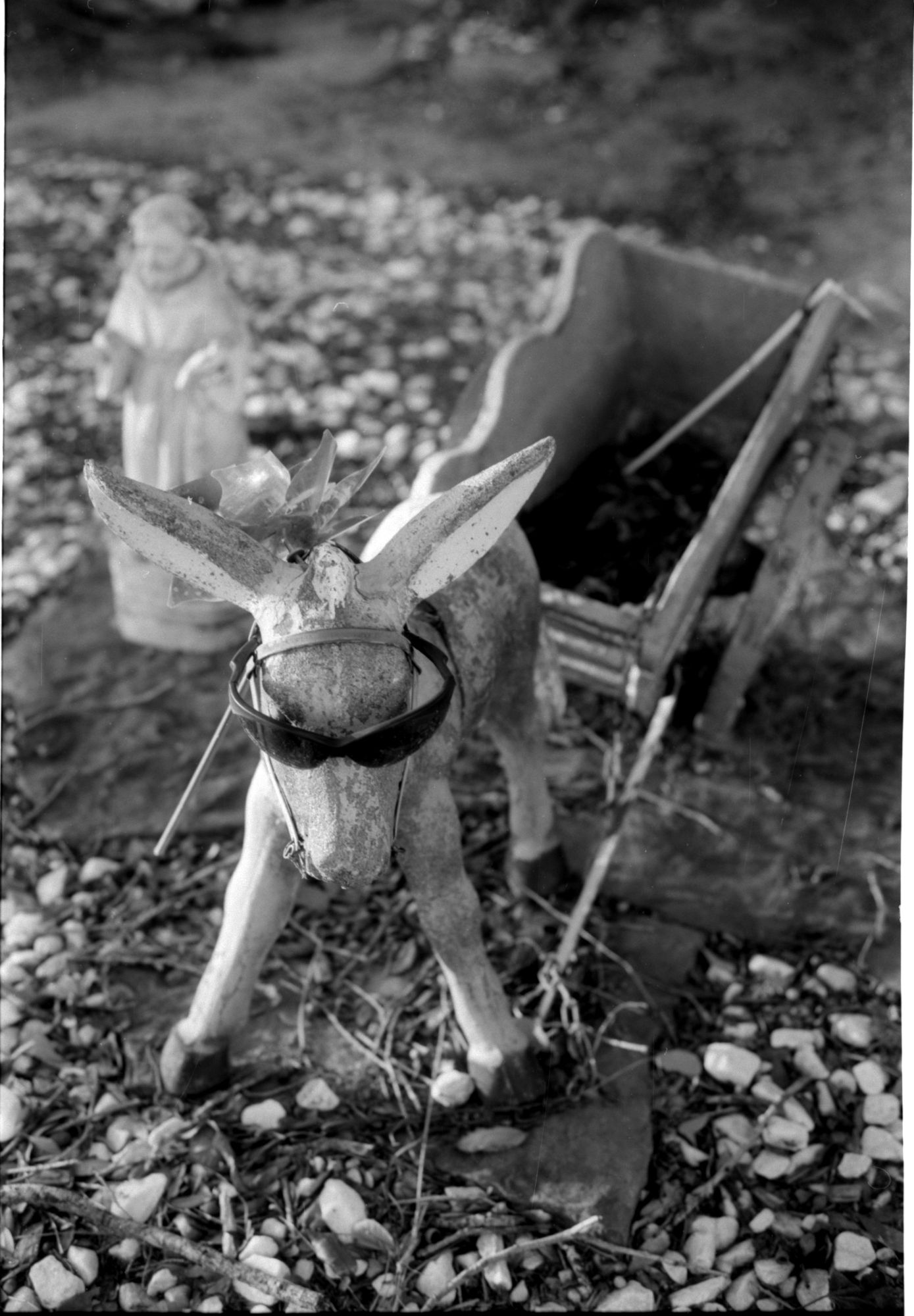

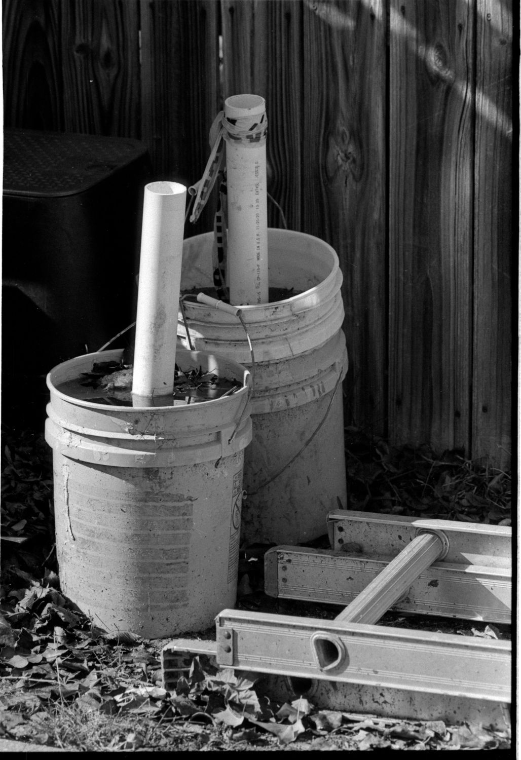

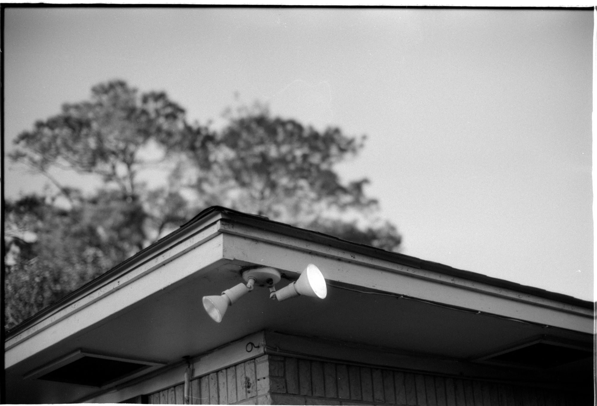

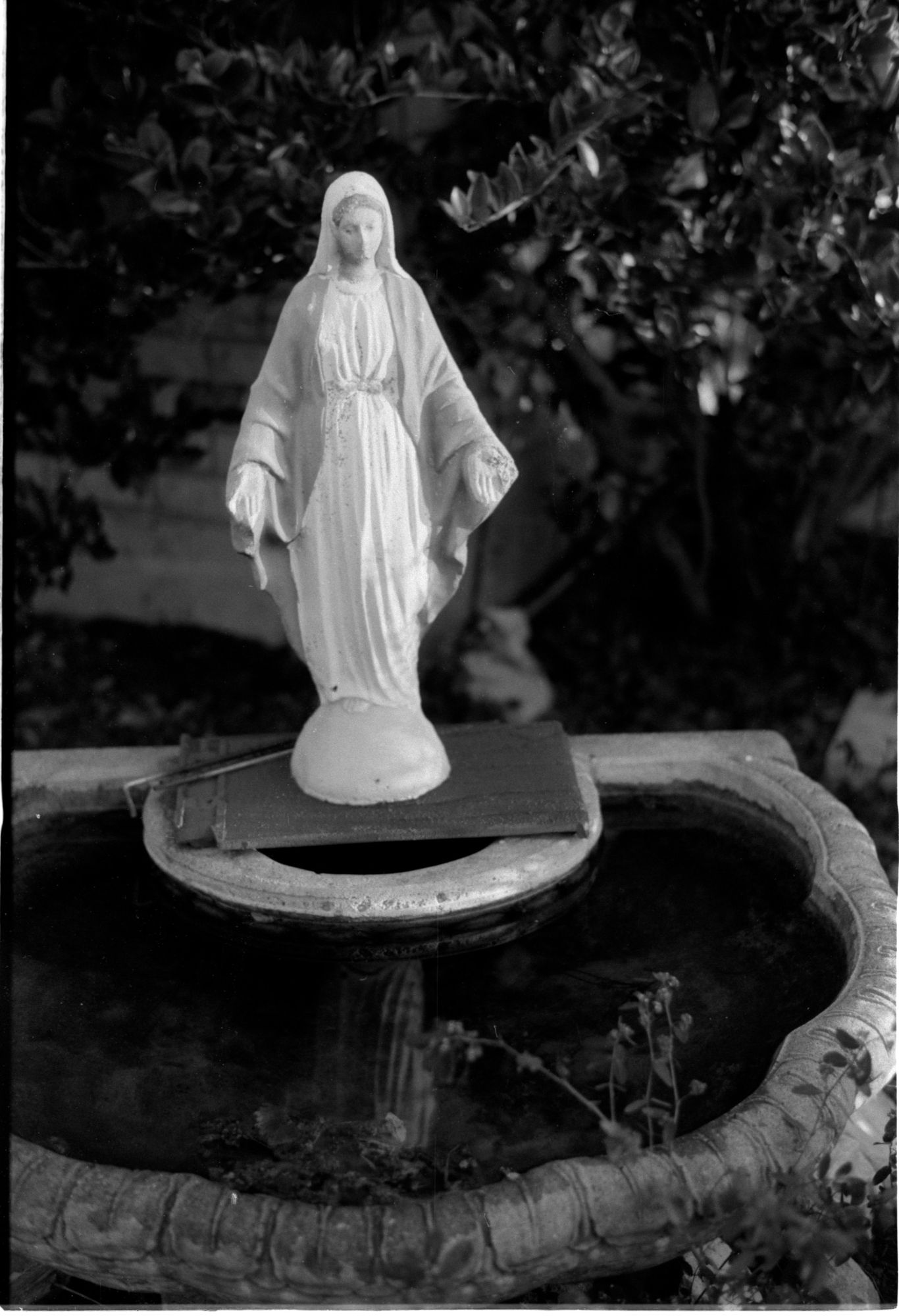

I developed a roll of Ultrafine 100, exposed at EI64, in XTOL for 7:30 min. at 20C in Jobo. My XTOL is almost fully seasoned now, so the time might not be right, but I am impressed with this film's tonality and overall emulsion quality. I have found no major defects so far. It dries flat. In XTOL, the emulsion side is shiny, so my aging eyes had trouble telling the sides apart. I also like how it renders skin tones and skies. It turns out to be a decent film, despite the bargain price and packaging. I probably would still prefer Fomapan 100 / Arista Edu Ultra 100 because it's a film I have been using for years and have come to like it a lot.
These are all straight scans out of Vuescan default settings for a generic black and white negative. Yes, I know, Vuescan does apply some processing of its own, but these are otherwise unmanipulated.
2022-12-01-0010.jpgUF100_2022-12-01-0016.jpgUF100_2022-12-01-0013.jpgUF100_2022-12-01-0009.jpg

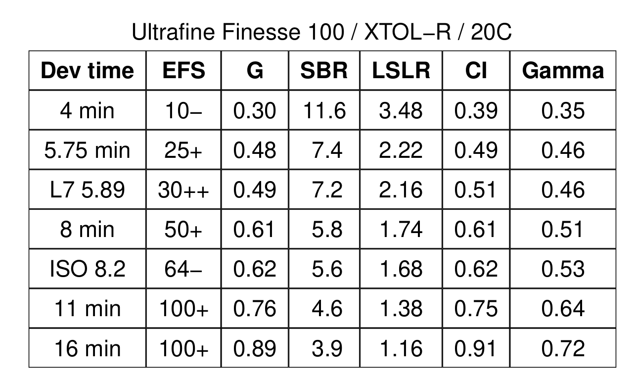

I ended up running another five-curve film test of the Ultrafine Finesse 100, this time in replenished XTOL. I really like the combination. The Finesse 100 turns out to be around ISO 64, fairly inexpensive, and capable of respectable results. Here's a summary of the analysis:

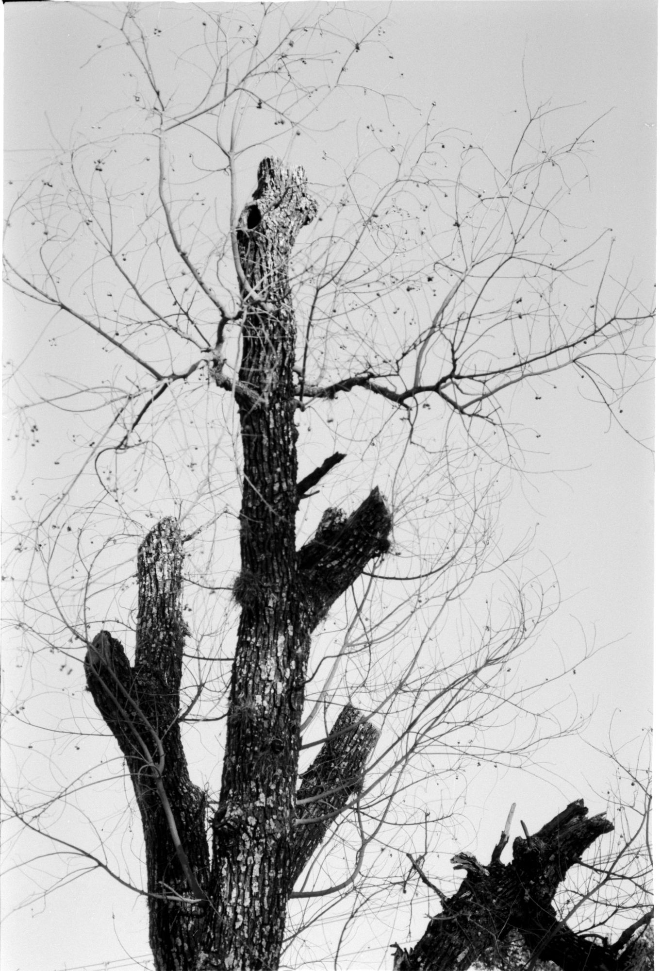

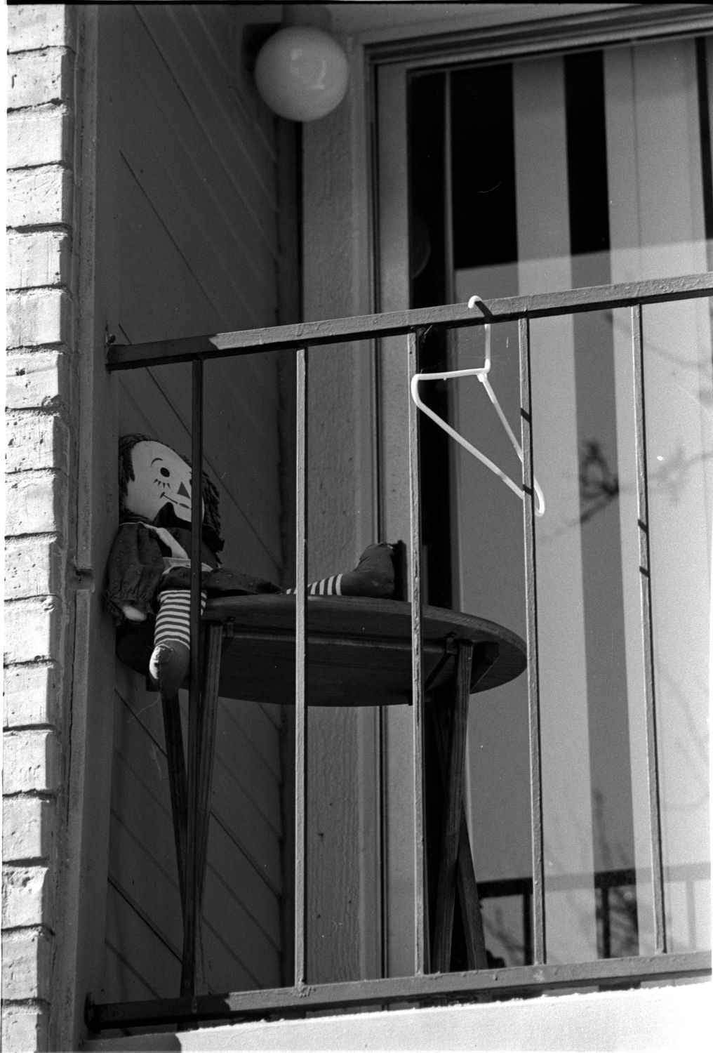

I have shot and developed another roll of Ultrafine Finesse 100. I exposed at EI 64. This time, I developed it in Adox Rodinal 1+100 for 40 minutes with a semi-stand agitation (2 minutes continuous, then two inversions after 20 minutes, then stand). The film responds to Rodinal very well. It gives just the right amount of contrast, good sharpness, and good tonality. Grain is fairly small. These are all "straight" Vuescan scans, just resized.
2022-12-25-0012.jpg2022-12-25-0010.jpg2022-12-25-0008.jpg2022-12-25-0007.jpg2022-12-25-0002.jpg
View attachment 324866View attachment 324868
View attachment 324867View attachment 324869View attachment 324870View attachment 324871View attachment 324872
