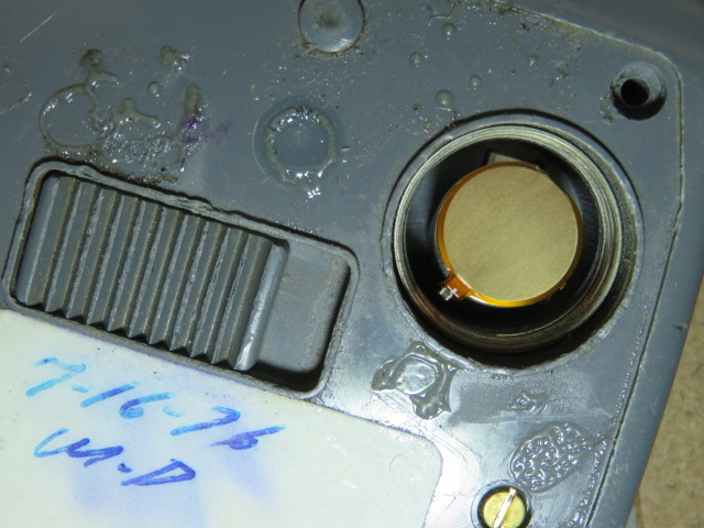

I've recently gotten a couple of Luna Pro light meters and learned about the issue powering them. Being an EE I've [of course...] decided to design and make a proper battery adapter supplying 2.7V from a lithium battery replacing stack of two original PX625 mercury cells. Not a diode voltage drop thing (that works better than nothing, tested that, but that's not really a very stable voltage source).

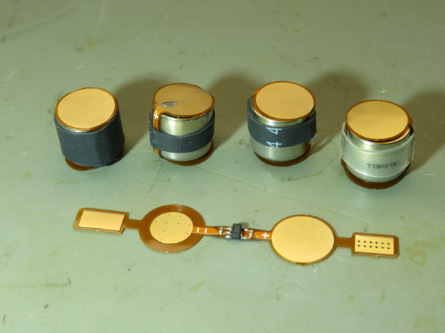

So I've tested 4 different parts to see which would be the best overall: Diodes' AP7350-27CF4-7, Toshiba's TCR3UG27ALF and TI's TPS78227DDCR and TPS7A0228DBVR - all micro-power voltage regulators. Standby current consumption is quite negligible, around 400nA, which guarantees standard 3.3V Li cell to work for several years. The TPS7A0228 has even lower standby current - just 25nA which is remarkable (my measurement revealed 35nA for the sample chip on hand), but that reg is only produced with 2.8V output. That is just 3.7% more than nominal 2.7V, well within tolerance of two former mercury cells. So powering something like Luna Pro would not be an issue - I've tested these light meters powering them from a variable power supply and within +/-0.2V the pointer remains within red BATT CHECK swatch, e.g 2.5...2.9V range is technically OK. At least for this gadget.
In my tests a +/- 0.2V voltage change makes the exposure reading deviate by +/- 1/3 EV. Powering from 2.800V source resulted just 1/6 EV higher readout than powering from 2.700V.
Rough estimation on the back of a napkin reveals that with even with 500nA standby a standard CR1/3N which is 175mAh capacity, it will take 175*10^6 nAh/500nA=350,000 hours to discharge one cell constantly connected to the regulator. That is 14,583 days or 40 years. A cell will die from the self-discharge far before that. Not to mention life time of its owner :smile: so I don't thing this is a concern.

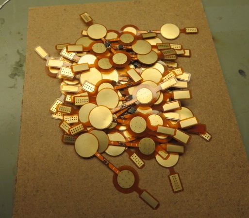

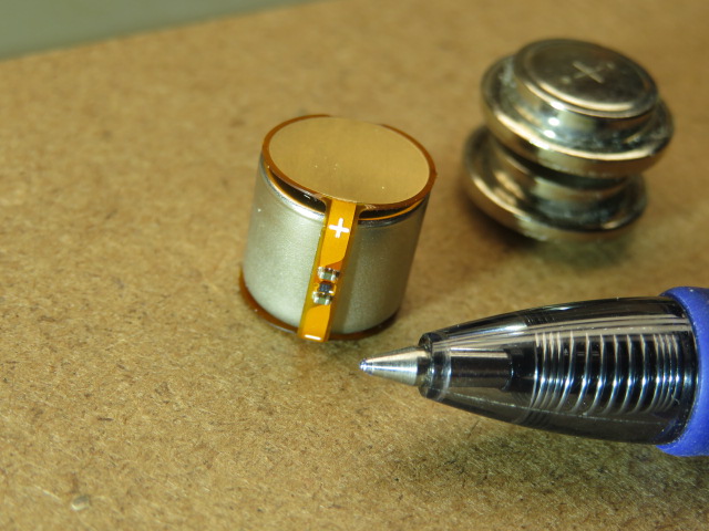

Anyway, I've mounted the chips on a flexible PCBs wrapping around CR1/3N lithium cell - it works just fine, though mechanically this design could be improved - it's difficult to assemble by hand. There was a minimum required order to produce these PCBs, so I ended up with way too many - about 60 or 70 extra assembled adapters that could be put to better use than collect dust in my parts bin. Would that be something people would be interested to acquire for their Luna Pro's or any other photo equipment that meant to use a stack of two mercury cells? I'm not planning to make money on these, that's a hobby project, but just recovering cost of manufacturing these prototypes would be nice.
If there's at lest mild interest from people to try these, I'll move the thread to classified section, but asking here because not sure if it even worth bothering.
If you have an opinion on the subject, please share. Thanks in advance!

Do you mean a replacement for a single PX625 mercury cell (size wise) for any cameras or photo equipment that was designed to use just one of those cells?
It is not difficult to resize (shorten) the side link with regulator ship to make the stack one cell tall (not two stacked cells tall), but how do I know if such a wrapped
cell will fit into your hardware?
I suppose it will fit as song as overall dimensions of such a wrapped PCB design do not exceed former PX625 mercury cell.
But I don't own any vintage photo equipment, however I know many of those cameras cameras use built-in light metering. I just have no idea how
much more common was to power any of those cameras with a single 1.35V cell rather than with two cells in series. Can you give me an idea?

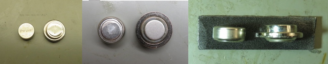

- I just put both - 357 cell (identical to SR44 size wise) and modern PX625 replacement made after merc. cell dimensions) side by side (attached) - they are very different. Yes, a PX675 is listed as the same size as SR44, meaning it's smaller than PX625 seen on attached photo. So, if your camera uses a PX625, the SR44 sized cell has plenty of room around it for three required regulator components - the IC itself and two capacitors. If your camera uses a PX675, the SR44 with electronics may or may not fit - I guess depends on the size of the battery compartment - how much extra room is designed around it.

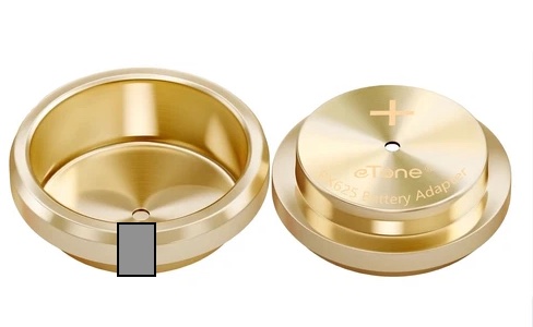

I was thinking of something that, yes, wrapped around a single LR44 cell. Looks like this PX625 adapter could easily be slotted to accommodate the voltage regulator.

- I just put both - 357 cell (identical to SR44 size wise) and modern PX625 replacement made after merc. cell dimensions, I think it's a zink-air replacement since has two holes in it. Side by side comparison is attached - they are quite different. Yes, a PX675 is listed as the same size as SR44, meaning it's smaller than PX625 seen on attached photo. I've seen a ring adapter around 675 making it 625-like. I believe the difference in diameters is 2mm, which is the thickness of the ring. So, if your camera uses a PX625, the SR44 sized cell has plenty of room around it for three required regulator components - the IC itself and two capacitors. If your camera uses a PX675, the SR44 with electronics may or may not fit - I guess depends on the size of the battery compartment - how much extra room is designed around it.
This will not be feasible since the top of the adapter surface will have to be output at 1.35V while inner walls of the same metal chunk are at 1.5V input voltage. E.g. the top of the cell you're using will have to be isolated from the top of the complete adapter solution, so a solid metal adapter won't cut it, even if you slot it to fit required electronic components . Pictured adapter can only adapt an LR44 mechanically.
