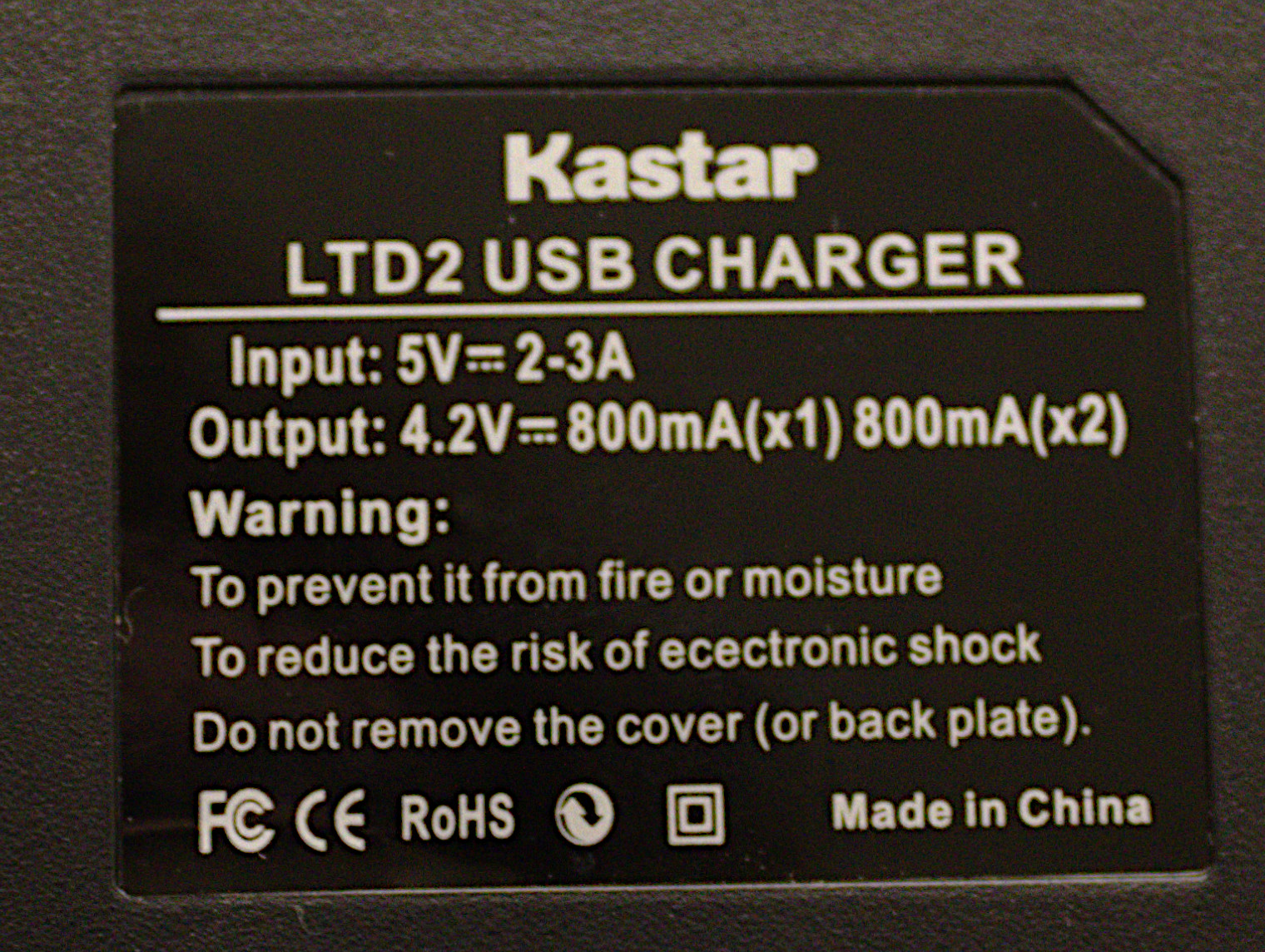

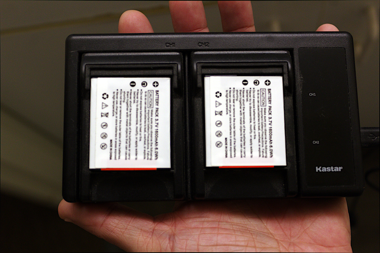

I included images of the charger

It's the EU common charger directive that requires a lot of devices that the wall adapter must be sold as option. The rule only in the EU but manufacturers would do it for products worldwide instead of making different products just for the EU.
Yes, the best thing to do is to get a USB-C power supply that is capable of delivering 5v @ 3A. This 20W Amazon basics USB-C power supply would be very good choice...

It's quite rare now, but there are some stunningly dumb devices (like battery chargers, coincidentally) that don't work with some implementations of PD (which the Amazon adapter has), because they were designed for an era when they used a resistor either internally or in their "special" charging cable to tell the upstream device how much current they would like (hello Apple), and for some reason the PD feature in the adapter fails to default to 5V.
I see your Kastar doesn't monitor the battery temperature, so it probably doesn't make 800mA available to a battery anyway. If you got the set with Kastar batteries, I bet the T terminal on them is a dummy, too.
Thanks for the information, Bushcat. Yes these came with the Kastar batteries. I did get them charged last night. Now to see how long they will last with this camera.
