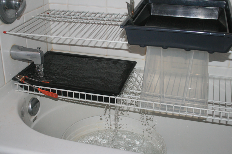

For the tub, I use two cut-to-size (at Home Depot) wire shelves separated by three plastic bins. The lower shelf sits on the rim of the tub, while the top shelf sits on the three bins.
Here is a photo that shows one of the bins with my fixer tray above it and my top wash tray on the bottom shelf under the faucet. My other wash tray rests on the bottom of the tub.
The water flow is turned up for the photo. The stop bath and developer trays are to the right, above the other two bins (and out of the photo.
Those trays are Paterson 12x16 trays with an 11x14 tray inside - cuts down on drips.
This is brilliant!
