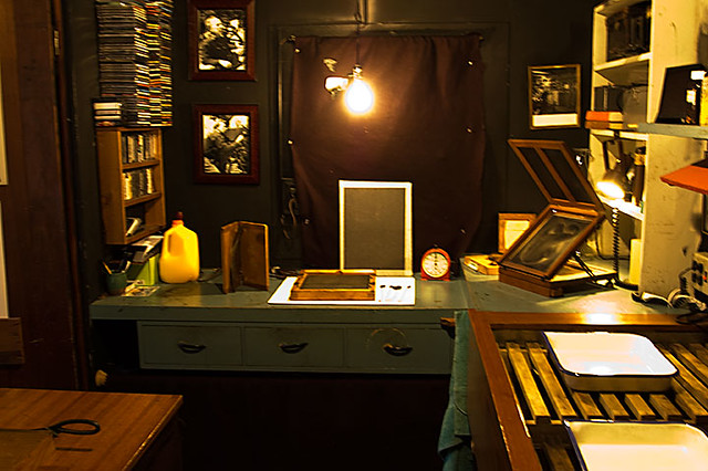

Edward Weston's darkroom. He just used a bulb hanging from the ceiling. Of course he was using very slow contact paper.

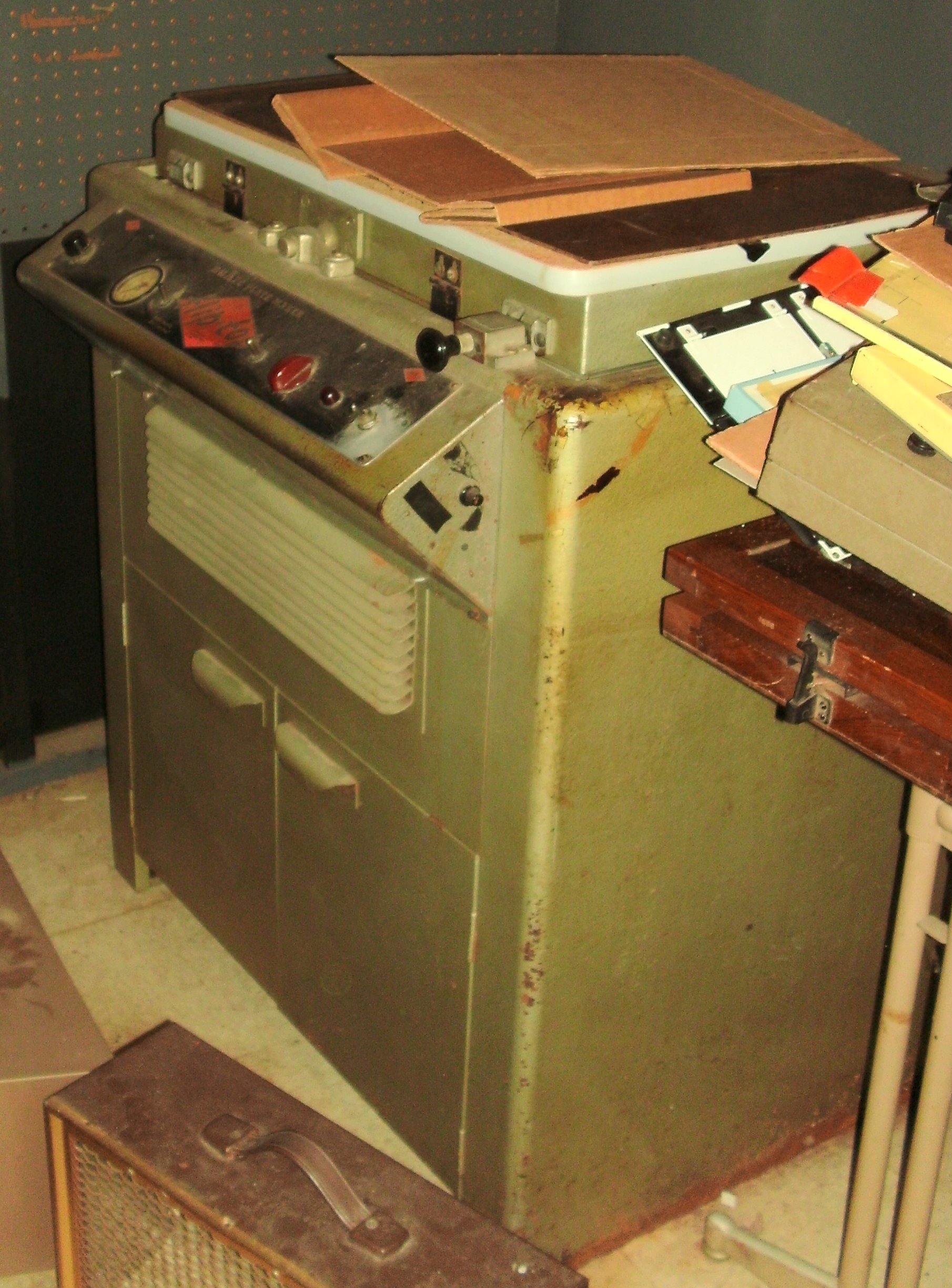

We had a dedicated contact printer in my parents' studio (*), but we also had one that we rigged ourselves. We used it for making larger contact prints, proof sheets, and the tens of thousands of photo paper samples we made for Luminos to give out at trade shows (which were four identical 4x5 negs stripped together with red lithographer's tape; we'd slice the resulting 8x10 prints into individual 4x5s after drying.)
The negatives/paper were held in a 24x36 vacuum frame on a NuArc (pic below: a huge steel arc-light-lit device intended for burning offset printing plates - you flipped the vacuum frame over to face down at the arc for that process; we left it face up for doing contacts); the light came from a "point source light" projector mounted on the ceiling directly above the frame, controlled by a Time-O-Light timer. I have no idea what kind of bulb and lens was in this thing (it was just a black cylinder), but it wasn't bright enough to disturb work at the enlarger and developing stations elsewhere in the darkroom. Exposures ranged from about 5 seconds to 20 seconds on standard enlarging papers.
I know this isn't exactly germane to the question about how to do basic contact printing with a printing frame. I'm mainly mentioning it because moving the light source further away allowed better control of exposure times on enlarging papers.
(* Our floor-standing contact printer - which doubled as a table holding a Durst M600 enlarger we used for 35mm negs - was mostly used by my mom to contact-print the ID photos we made for passports and drivers licenses. We shot these on 2-1/4 x 3-1/4 inch sheet film, measuring the required regulation sizes for the head right on the camera ground glass so they wouldn't need resizing with an enlarger. For these prints, we used 2x2 inch Kodak Azo contact paper.)
