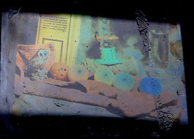

Ethyl violet will work pretty well - it was the red-orange spectral sensitizer used for autochromes, as 'boring old man' stated previously. It starts to lose sensitivity as you go into deeper reds compared to pinacyanol, but depending on how you plan to use it, there's a good chance it'll get the job done.
I actually never got around to using it with my autochrome work, but I did use it with many of my earliest Lippmann plates:
