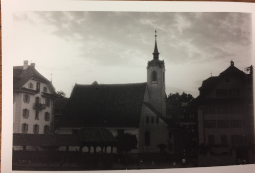

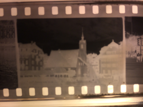

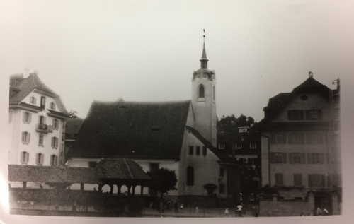

I have a negative that is super dense and contrasty that I've attempted printing but haven't had much success.
The sky can be brought in on one exposure length, and the buildings in shadow can look right when exposed separately without regard to the sky.
What I can't seem to get is the buildings looking right but also get sky detail; either the sky looks good but the buildings look darker or more lifeless than I want, or the buildings look good and the sky looks perfectly white.
The first print is the straight (get the buildings right) print and the second print is the print where I burned in the sky but the buildings don't come out bright enough. I can't get both for whatever reason.
Is this impossible or is it just my lack of skill that's stopping me?

I didn't mask the sky I just used a cardboard piece to mask but I could try making a mask. So can I ask: is this a real big deal or am I just a bit inexperienced? Would you call this a difficult negative or not that big a deal?
This is a good example of the need for manipulation of exposure when making prints that include the sky. I agree with the suggestion of a mask that covers the lower part of the frame where the buildings are, the mask can be something as simple as your hand in the light beam a few inches above the paper, it is sometimes a good idea to vibrate the mask slightly to soften the edges (but don't move the paper). This is called burning-in the sky.
It isn't a question of experience, the sky is too bright, to print the clouds needs much more exposure time. The fundamental problem is that when we see a scene our eyesight makes automatic adjustments to the brightness of the parts of the scene, we are able to see the clouds AND the buildings. However this is a trick of eyesight, and film does not perform this clever trick, it shows what is actually present, a dazzling bright sky and shaded buildings.

Ok...so the consensus is; this is normal and I need to make a better effort at burning in the sky. No problem, that's part of what I needed to know.
One last question; when burning in for a long time, does it affect the masked areas at all? Do they change? I might have made a mistake but it seemed like mine did.
Yes if any light "leaks" past the mask the masked area would be affected, it also would get darker. Be prepared to experiment with this, it is a hand skill that is very useful to have, make prints of the same image with different burning in times and mask methods. This is a skill that is learned easily with practice.

Thanks. I won't let this negative defeat me! :smile:
Are you using fresh paper? The border on the print doesn't look white.

It is just a question of experience - the negative is perfectly printable but you need to have developed a range of skills to achieve this. However, do not despair, with time you can master such negatives and, in doing so, will have built up your knowledge and skills base ready for other difficult negatives in the future.
