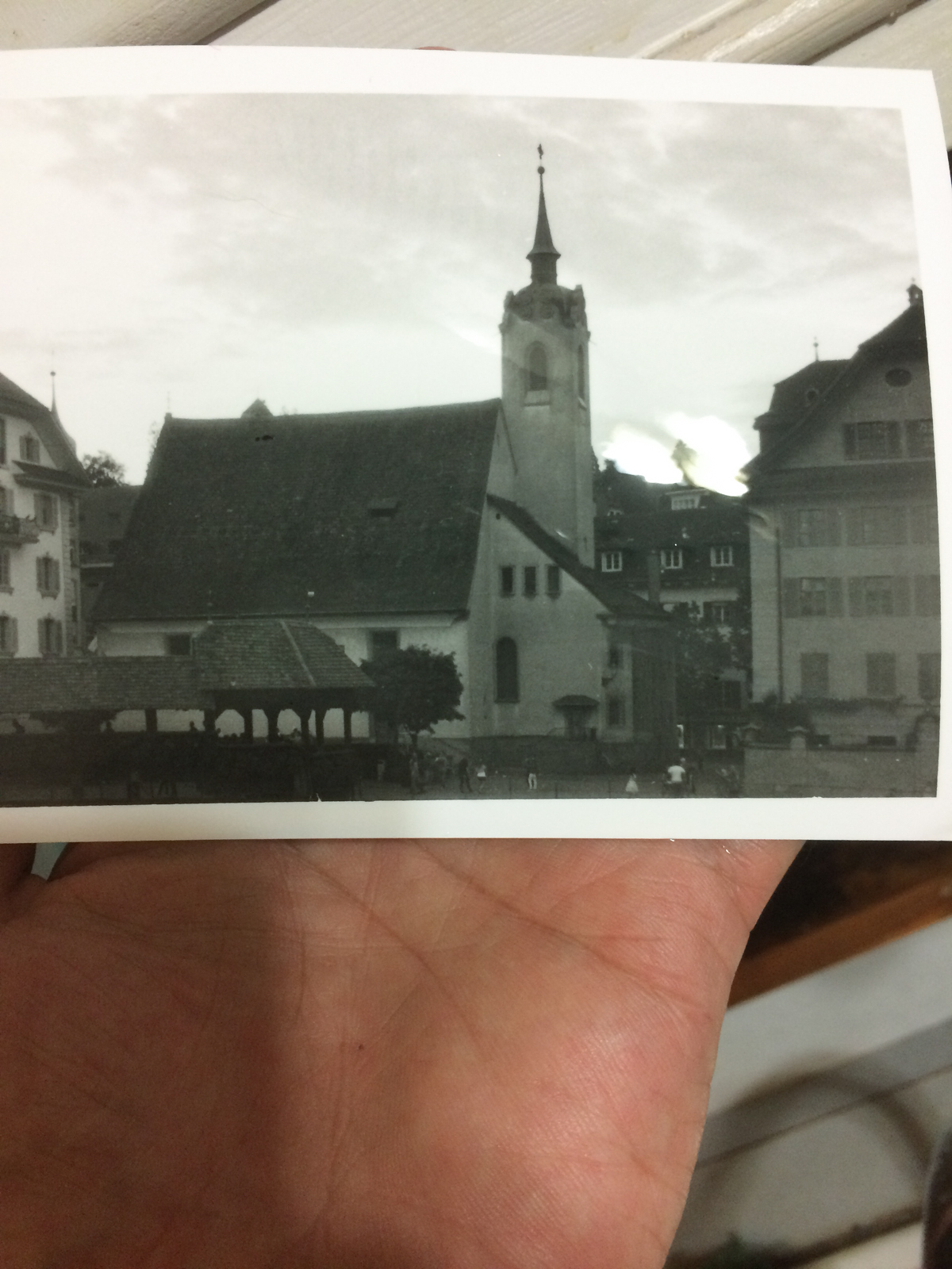

Well, thanks everyone. I gave it my best shot for now. I ended up printing with a grade 3 for 27 seconds to get the buildings where they needed to be and then changed to a 00 filter and burned the sky in using a cut out mask of the buildings for another 25 seconds.
I asked my friend (the owner of this negative) just how low the light level was when he took this and he said that the buildings were in very deep shadow, the scene was backlit as the sun was going down behind the buildings. That's probably part of the problem, there's almost no contrast in the buildings themselves but there's TONS from that to the sky. it's much easier to print when you leave the buildings as a silhouette...it almost prints itself!
(in the picture, what looks like a blown highlight is just a reflection of my kitchen light)

View attachment 166026 Well, thanks everyone. I gave it my best shot for now. I ended up printing with a grade 3 for 27 seconds to get the buildings where they needed to be and then changed to a 00 filter and burned the sky in using a cut out mask of the buildings for another 25 seconds.
Nice! You could also try doing the same thing but use a higher contrast filter like Grade 4 or 5 and see how you like it.

Keep in mind that pre-flashing is similar in effect to burning with a lower-contrast filter; it gives more exposure while reducing the separation between the highest values. More pre-flash = less separation in the very highest values. Using the two techniques together may make your base exposure for the buildings easier.
I've often used a cut-out outline mask like Matt describes above. The trick is to find the compromise between coverage and blur so that there are not noticeable halos around the building tops.
David's suggestions are super.

So, would you say that this is a true statement; if the negative has the information then it can be brought out with enough effort. ?
yes

Used to make contrast masks for Cibachrome printing, it can be done even with 35mm negatives. And if you were really "gung ho" you could make an enlarged positive and then a negative to print. These sort of negatives are excellent "learning experiences" but in real life I'd probably just sc*n the dang thing and make a d*gital print.
