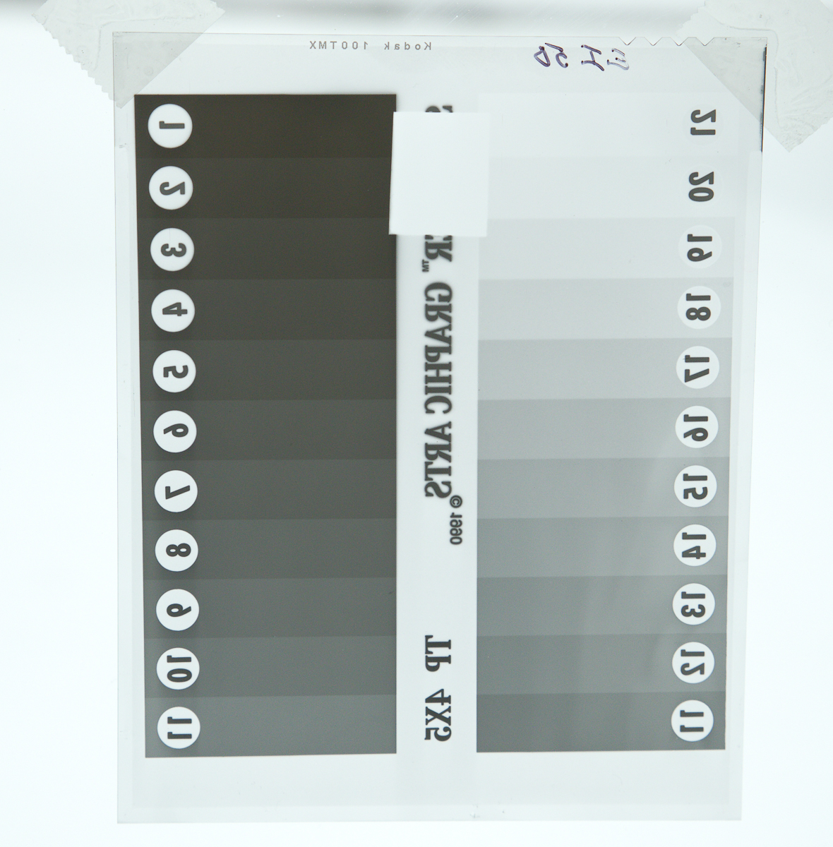

I'm about to develop two sheets of TMX 4x5 film contacted with a step tablet to generate a couple of curves. Since it is a tabular grain film, I'm going to assume, right or wrong, that even with the BT2B developer or just a divided developer in general, that the film will be just as sensitive to a one-degree change in temperature deviation as with using any one shot developer. For curve evaluation, I want to keep that variable consistent with how I'm developing TMX in XTOL currently, which is 68F..........currently waiting on both baths A & B to reach 68F.
I'm thinking I'll do 4min 30sec time for both A and B baths. As far as agitation goes, I'm going to follow BT's words and not agitate in bath B since it is a sheet film and should not be subjected to those sprocket streams he mentioned, and I'll not use a pre-wash. For bath A, I'm thinking I'll agitate just as I do for XTOL, 10 sec initial with 5 sec every 30 sec. However, I've got some time due to waiting on the tempering bath, if someone with more experience with T-grain films and using BT2B can suggest a better time and agitation scheme, I'll be watching.

Well, the temp reached its mark and so I had to start...........the negatives definitely have some issues. Perhaps it is the warning that @retina_restoration mentioned, idk. But I will not produce curves from these negatives. I taped these to a window to use the bright snow outside for the backlight. These are TMX and are differentiated by one being exposed at box speed and one being exposed at 1/2 box speed. I chose a half box speed example because I currently rate TMX at EI50 in XTOL 1+0 and wanted to compare with BT2B. For the ISO100 sheet the issue is the straight angled higher density line through steps 6 to 8. For the EI50 sheet the issue is from steps 11 to 16. Trust me I have never in my years seen either of these types of issues on any sheet that I have ever tested.
I'll reiterate the particulars:
- the sheets were developed in an SP445 tank; the negatives are oriented to you as they would be in the tank's film holders, one sheet per holder; I did not put two sheets on one holder.
- development was 4.5 min x 4.5 min at 68F
- bath A agitated by 10 sec initial agitation with 4 inversions (forward to backward) every 30 sec after that. Agitation was exactly like I do for TMX in XTOL..
- bath B received no agitation.
I don't have BT's books so I'm wondering if there are any specific notes as this process relates to T-grain films. A question I have is.....is it possible that this occurred in bath A and not bath B? Does a T-grain film need more time in bath A for complete soaking of the emulsion? Idk, just my thoughts. I'd be interested in other's thoughts.
I have already exposed two more sheets in the same manner but wanted to hear other's thoughts before deciding on a time and agitation scheme and I'll develop tomorrow. I'm giving myself 6 sheets to get this BT2B processing to a point I can call it successful, two down four to go. If not by then, then it'll have to wait a while.

I suspect you’ll find that the Tmax films will misbehave if you do not agitate at least one or two inversions per minute. Carry on.

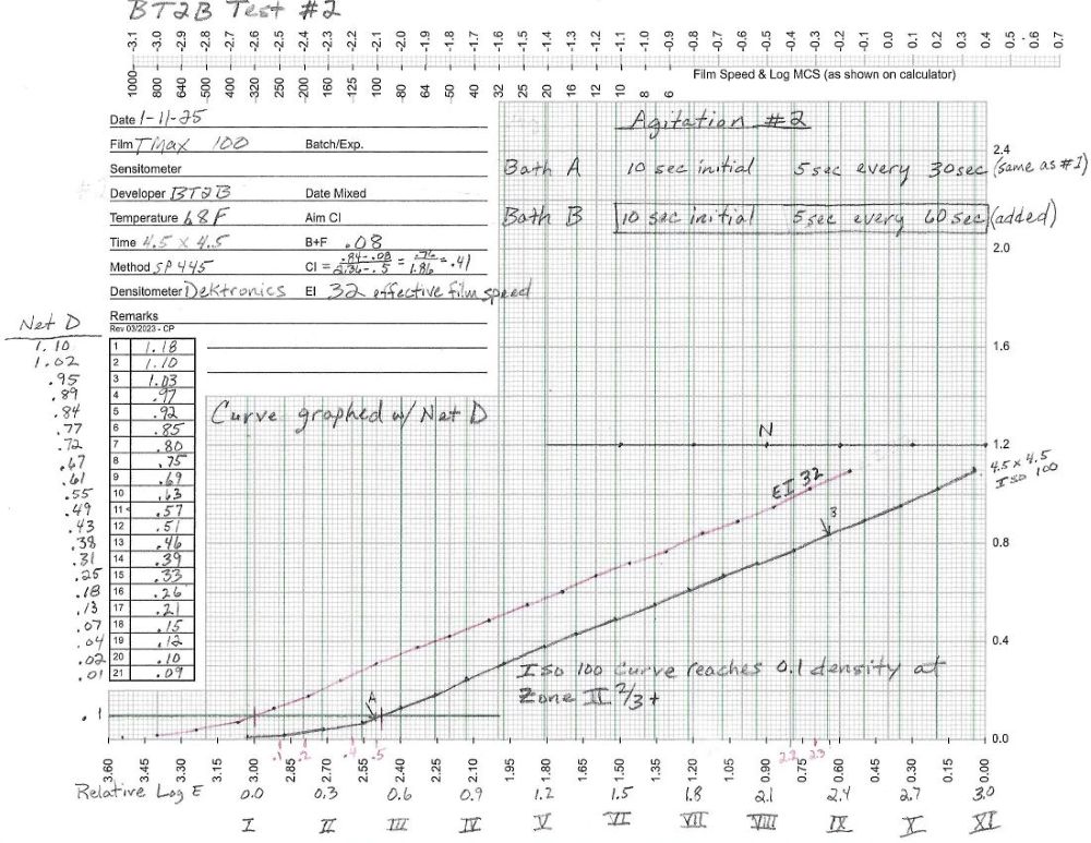

I can't point you to any sensitometry besides my own (see attached extract/examples) because I don't know of any, but if it helps at all I'm not the only one who noticed the "straightening" effect - I recall an article Sandy King wrote about his own experiments with two-bath/divided development in which he discussed a similar finding, which led him to opine it might be a useful thing for negatives destined for scanning.
I don't think "restrained highlights" says much on its own. It has to be relative to something such as an overall gradient, emulsion speed, contrast on another part of the curve, etc. I think a better characterization of this type of development is that one can reduce the overall gradient while substantially retaining emulsion speed and without over-flattening of highlights. It's different than what one typically thinks of as "compensation", where there is highlight compression relative to the midtone gradient.

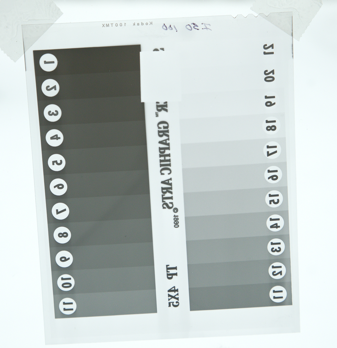

With my 2nd test sheet of the BT2B developer I was able to obtain a clean, uniform negative with 4.5 min in each bath. @retina_restoration warned of the possible problem with no bath B agitation but I wanted to give it a try as BT said it was "ideal" with films without sprocket holes, now I know. However, it's not abundantly clear to me if this is specifically because of it being a tabular-grained film or if it is a general issue with all films when there is no bath B agitation. That said, the issue did clear up with the bath B agitation you see implemented in my notes on the graph below. In trying to keep with BT's statement, the agitation was kept fairly minimal at 10 sec initial and just 5 sec every 60 sec in the B bath.
The film was rated at box speed. I prefer viewing the x-axis in relative log exposure units to display the zones separated by major divisions of 0.3 units of exposure that coincides so nicely with how we use our shutter speeds, aperture rings, and ISO dials on our meters. The original ISO 100 curve does not reach a 0.1 density until a whopping 1 and 2/3+ stops down the road on the log exposure scale, a major loss of speed. So, in keeping with Schaefer, to reach the preferred 0.1 density at Zone I, each step density is shifted 0.5 log exposure units back to the left and the shifted curve is re-drawn to show its relative position on the log E scale at Zone I.......if it had been rated at EI32. The negative is definitely soft like it is supposed to be, perhaps too soft.
The 1.2 density line is my visual for comparing my "Normal" single bath development time of 7min 30sec with TMX (rated at EI50) in XTOL 1+0. I target a Zone VIII density of 1.2 for "N" development, for a density range of 1.1 from zone I to VIII. I've read that expansions and contractions are not doable per se with divided development but that the gradient can be manipulated with how long it stays in bath A. I think this screams for more development in bath A and would be interested from those with more experience with divided developers as I'm a newbie with it.

I did a second sheet yesterday with a different bath B agitation than #2 above. I agitated 30 sec initial and then 30 sec at the 2 minute mark in bath B, but it produced the exact same curve as what resulted from #2.
