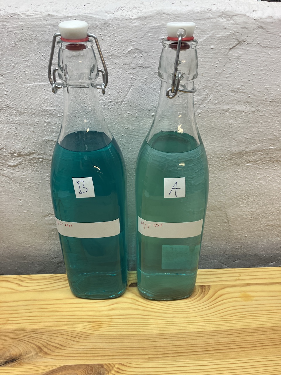

I developed 2 sheets of Fomapan 200 5x7 today in newely mixed Thornton 2-Bath and got strong coloration. Is this normal? Chemicals was mixed with deionized water and I let it sit for 24 hours before use.
However, the negatives turned out really well.
This is normal for Fomapan, yes.This film has a very intense emerald green anti-halation dye in the emulsion which comes out in the developer. Quite normal.
Your colors are vibrant! They look like Gatorades or Vitamin Waters. 🙂
My Part A comes back out looking like a champagne, golden rose, color and my Part B comes back as a lemonade looking solution.

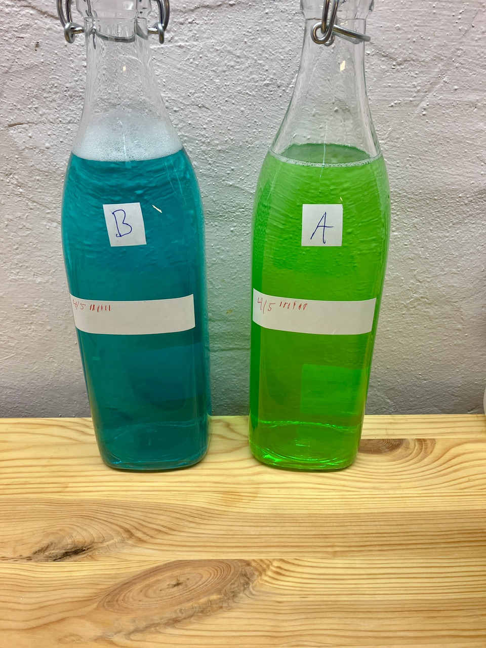

Just a quick update. Went down to the darkroom to develop some more 13x18cm sheets to find that the lovely color in bath A has disappeared after 4 13x18cm sheets. Not shure what is going on(maybe som oxidation?), but the developer still gives me beautiful negatives👍

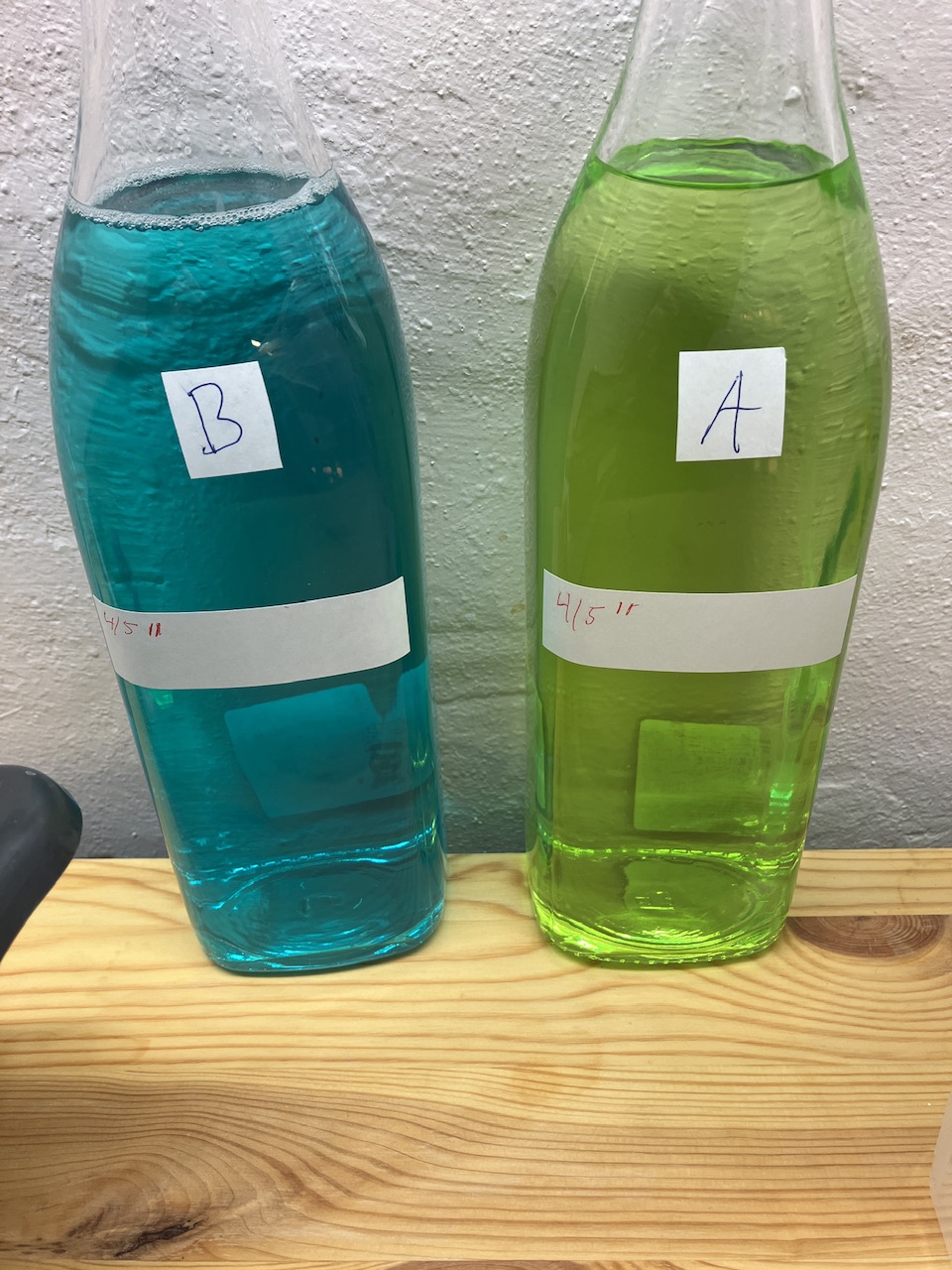

Two more 13x18cm sheets and the developer is once again colored like it was some kind of radioctive waste product😃
Anyone here tried Thorntons 2-bath with HP5+ pushed 1 or 2 stops?
I would be curious to see what others have for colors.
On my next film run I will take a picture of my Kentmere colors. A rosy-golden champagne color for Part A and a mild lemonade color for Part B. My guess is that my colors should be a little bit more saturated after another development run but not as vivid as like what you have going on. There should be a page on here for posting different films and their colors in these baths. Could call it: "Barry Thornton's color swatches library thread"

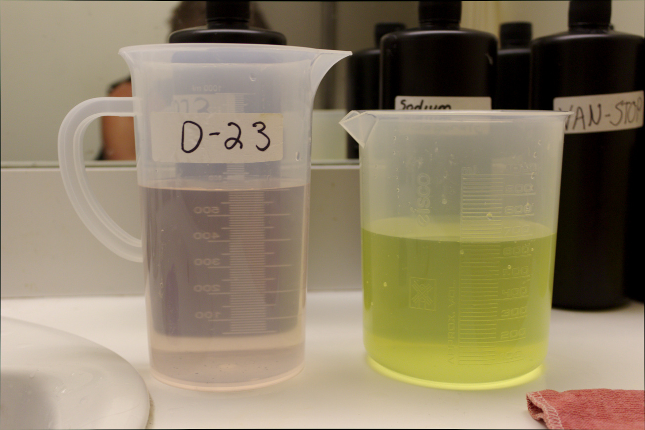

As I promised. Here are the Kentmere colors.
Looks like the Part B lemonade went more toward lemon-limeade after the second run.
My colors are not that exciting. Champagne or lemon-limeade, anyone?
