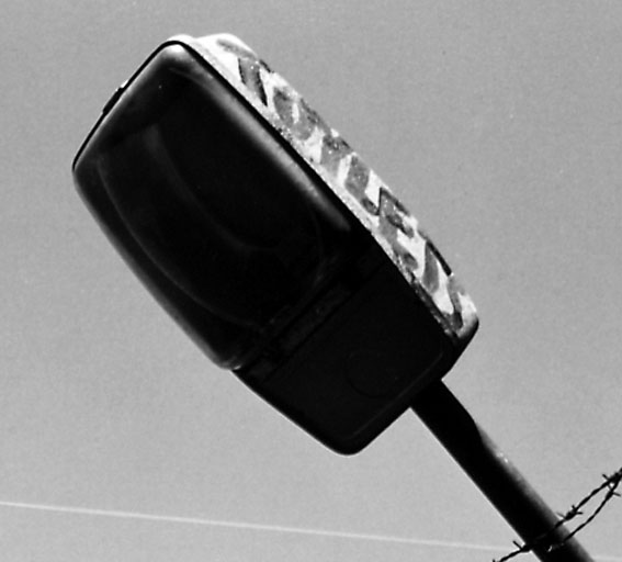

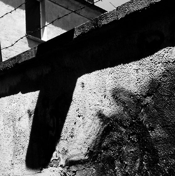

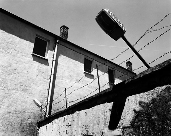

I have no idea if I am developing to a lower gradient as I do not undertake sensometric tests. All that I can say is that I process in each Bath for 5 minutes and this gives me negatives that print very easily of Grade III when using an Ilford 500 diffusing head on my enlarger. The prints demonstrate a full range of tones with minimal requirement for dodging or burning. In general, I print on a slightly harder grade for exhibition prints as that is the look that I prefer.
In this example, placing the shadow area under the barbed wire and the underside of the lamp on Zone III placed the white wall in full sunlight on Zone IX - X. Nevertheless full detail was retained throughout on the negative. When I did my first test print (using my tested minimum black time) the shadows and highlights demonstrated both detail and good micro-contrast. For the exhibition print, I did a bit of graduated burning-in on the left side to make the image more balanced and did a bit of burning-in on the bottom right corner to give that area a bit more weight.
I would have thought that, if I was developing to a lower-than-normal gradient, then the image would not demonstrate such a dynamic range and the feeling of intense sunlight. However, as I stated earlier, I am not one to do technical tests with a densitometer but fall in the camp of those who prefer practical tests out in the field (no disrespect for Michael and the others that test differently - it is just how I have always worked).
Looks like a print from a well-exposed negative that was developed to a normal gradient... I would bet that you have so much shadow detail that if you look at the negative, you could make out the shape of the light bulb.
Hi Bill, that is what I am thinking. I presume that full development in BTTB should give a normal gradient - although I have no way of testing this.
For web use, I re-photograph my exhibition prints with a Sigma SD9 and then adjust to match the prints as well as possible. However, I am well aware that everyone's monitor is different (generally I find that the images tend to look slightly darker and slightly softer on Windows machines in comparison to my Mac). Nonetheless, I would think that the overall dynamic range would come across.
Visually, the exhibition prints tend to look quite contrasty (think perhaps of Adams' later printing style or the typical difference between tonal taste in more eastern parts of Europe / Japan and that of the UK, France, etc) but you can see detail in both the shadow and highlight areas.
Here are two details to show the shadow information from the original SD9 copy of the exhibition print.
