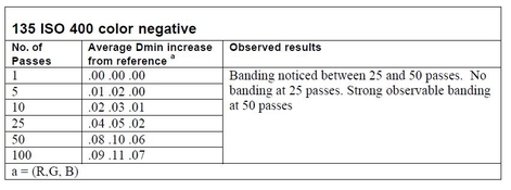

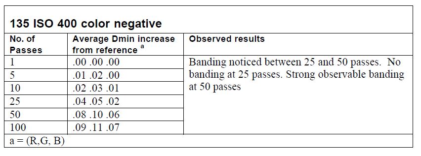

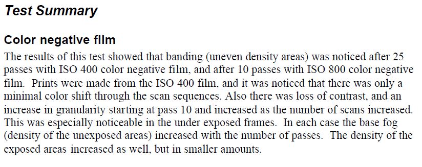

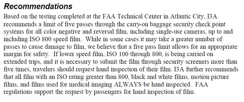

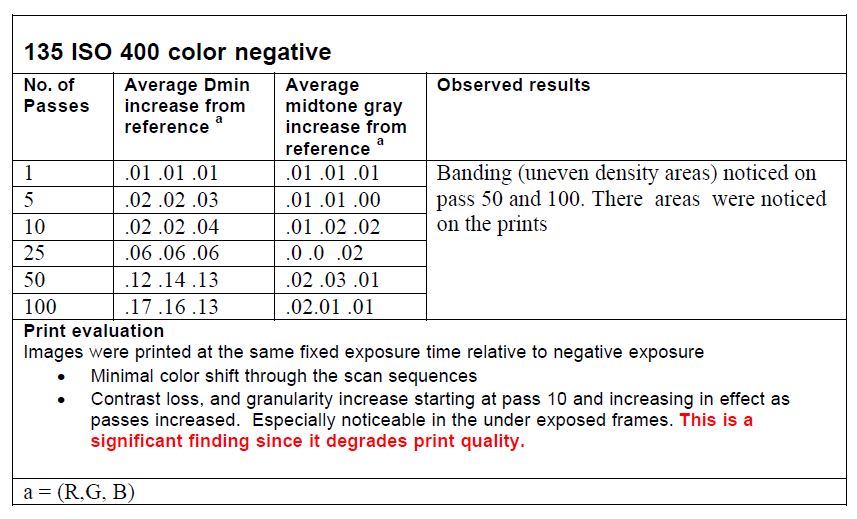

The engineers are stating that their scanners are safe, which is correct as they test by simply passing the film just once, and then developing it.
The "official testing" in 2008 that led to the TSA (and other) statements was quite a bit more rigorous than that. Here, from the official report of one joint industry study. (I've heard of a similar study in the EU/UK but have never seen an official report, only vague summaries.) It's worth noting that the scanner dosage on the traditional x-ray machines, in the United States, at least, remained virtually unchanged throughout their entire manufacturing period and were carefully managed within specs during usage.
See thumbnails for actual summary data of the ISO 400 color negative trials .
