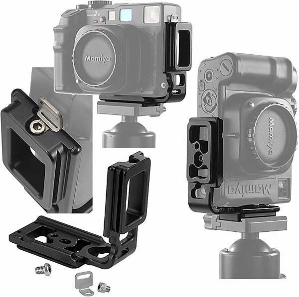

I've never been satisfied with manfrotto qr plates or ballheads. I've now got an acratech ballhead (v2) and kirk 'L' bracket for my mamiya 7 and kirk plate for my RB. This combo is noticebly more solid.
Sorry to borrow this thread Sandy.
I too like the Mamiya 7/7II Kirk L bracket for the Arca Swiss type QR. It works great making it easy to switch from horizontal to vertical.
Here is the Kirk link for anyone interested that is reading this thread:
Dead Link Removed
