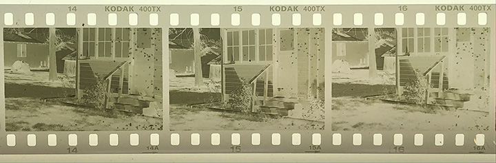

I was given a pristine Canon 85mm rangefinder lens, so I did what anyone would do and purchased a clean body on Ebay. These test shots tell me that the speeds are accurate but there is this pattern on all the negatives. The only thing I can think of is holes in the fabric shutter curtain...the camera is as old as I am. This is difficult to check as the body is a bottom loader. Any other thoughts or fixes? Thanks, Joe, 71
I suspect the shutter curtain too.
Good news is that this should be very 'repairable' if it is due to faulty shutter fabric. Which camera? It might be expensive but then you will know the camera is in good shape. High quality cloth focal plane shutter cameras should last a long time.

Those pinholes are tiny enough that you might be able to fix it with a quick single thin coating of flat black acrylic paint. Check which curtain the holes are in. Put a short strip of film in the camera, advance it with the lens covered, point it at a bright scene for a minute, cover the lens and press the shutter. Keep the lens covered while you advance the film and press the shutter with the lens covered. Uncover the lens and point it at a bright scene for a minute, cover the lens, advance the film to the end and develop it. If there are spots on the first frame, you need to coat the shutter with the shutter cocked. If there are spots on the third frame, you need to coat the shutter with it not-cocked. Just a very very light coat of flat black acrylic paint and, when it's dry, grind up some pencil lead into graphite powder and brush it onto the paint to ensure it's not sticky. Don't touch it for a few days.
Liquid electric tape is what often gets recommended for such repairs. Avoid that stuff like the plague. It takes years to lose its tack and it's too thick.
But I agree with awty - curtain replacement is the best option. Any fix is far more temporary. You never know when new pinholes will form. So you'll never trust the camera.

I painted the shutter of my Zenit (the original Zenit) with Dylon brand fabric paint. I had to do it through the lens throat, because the camera loads through the bottom, and I didn't trust myself to take it apart (I nearly did - I even bought some shutter cloth, but I lost my nerve). I gave each blind two coats, and allowed it overnight to dry between; so it took me four sessions of about five minutes each, over four days. The repair's lasted years.

It really won't hurt to try painting it. Those really are very tiny pinholes. I have a Leica IIIb that must've spent years on a shelf facing the sun - the arc of the sun was burnt into the shutter curtain. It must've been moved once - since there were two arc burnt. That shutter needed to be replaced.
A couple of thoughts. I've owned a couple of cameras with patched/painted light leaks that worked well, but they were both cases with a few clearly defined holes, probably caused by burning or puncturing. Yours are tiny and scattered all over, so would require a lot of painstaking work to find and cover. But the fact that they are tiny and scattered would also indicate that they're caused by deterioration of the rubber coating in the curtain fabric and as you use the camera and flex the curtain, more are going to appear.
On the optimistic side, you could try the painting method and see if it works--if it doesn't you haven't lost anything but the small cost of the paint. And you could pick up a Canon P which used metal shutter curtains.
