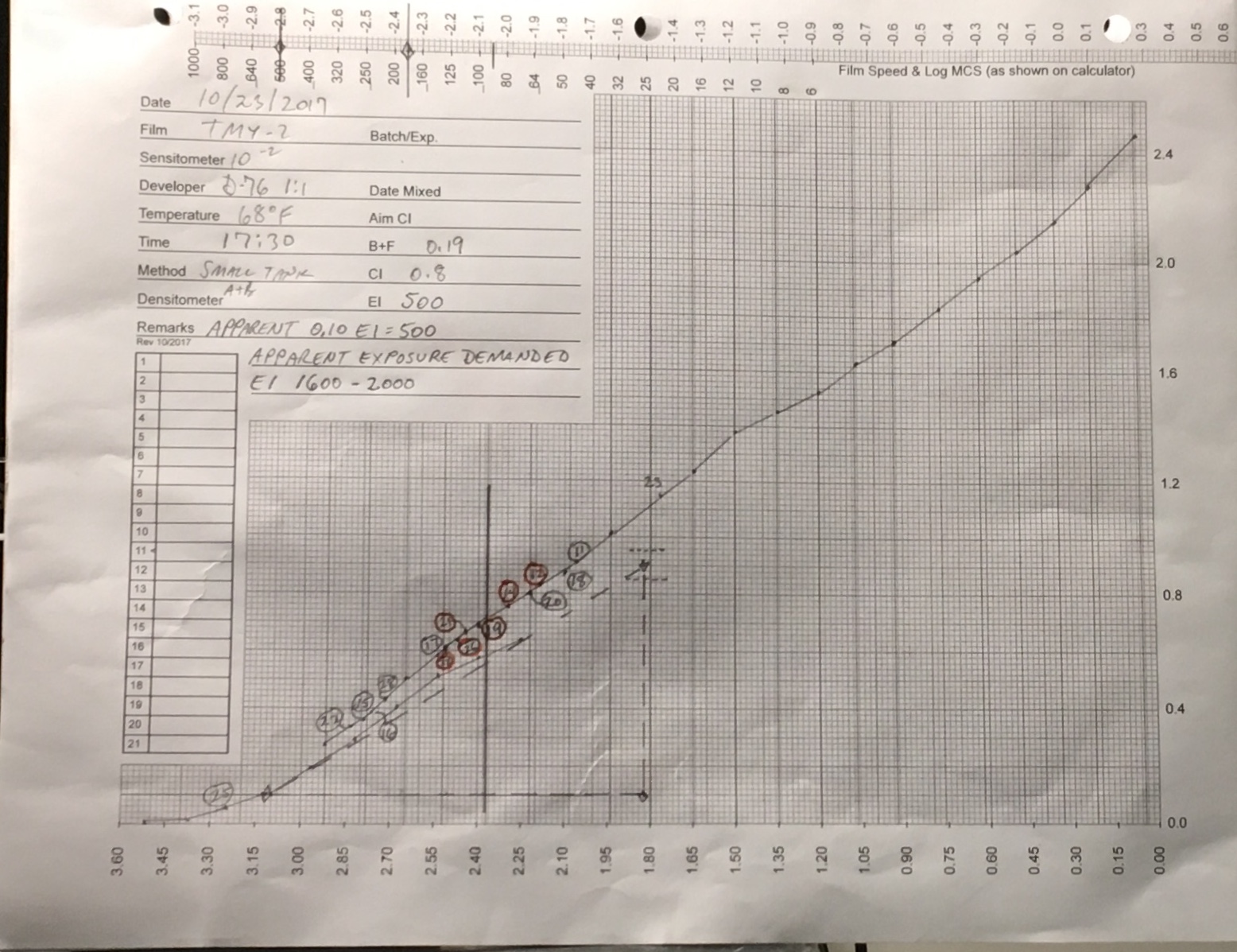

Reviving this thread because... Believe it or not it works!
Just last weekend I took some extremely important photos in a restaurant that was really dark. I took one meter reading of my palm and meant to (but forgot to) open a stop. Then I switched from an f/1.4 to an f/2 lens. Talk about two mistakes in the wrong direction! Fortunately I had the meter set at 250 for a 400 speed film so I got back 2/3 stop. Still I knew when I got home that I would have a serious under exposure to contend with.
I graphed out and planned my expected Zone VI density to be desirably 0.88 and the contrast index which might get that for me.
I aimed for 0.9 CI and achieved 0.8 CI. I actually cut the first roll in half because I had taken some outdoor shots in full sun and wanted good negatives for them too.
Now, analyzing the negatives reveals by working backwards that I had underexposed 1 stop more than my narrative so far!
But because I developed to 0.8 CI the negatives look great and are all printable.
By my graph here I believe it can be said that 0.8 CI (17:30 in small tank D-76 1:1 at 68 degrees F)... can result in an EI between 1600-2000 for TMAX-400... if you meter for Zone VI placement in a low-contrast lighting condition.
The orange-circled densities are readings of my friend’s faces. Working backwards I could say if I had taken individual meter readings and adjusted exposure per shot ... each should have been “placed” on Zone VI. They clustered around -2.05 log mcs exposure and one stop less would be the theoretical meter reading... -2.35 log mcs. Which is ten times the speed point.... -3.35 log mcs .
This means effectively I pushed this film to EI 1600-2000
And I hate pushing. It was never my plan. But I guess the photos are better for having been taken at 1/8 second versus the half second to whole second which might have been required if I thought this through when I took the shots.
