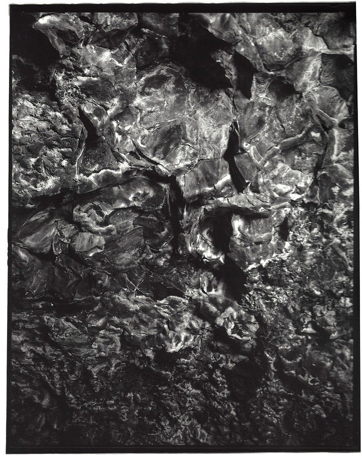

To answer the question, it is good for getting bats that hang from the roof of a cave in focus from the front of the cave to the back; not so much the floor.
...To answer the question, it is good for getting bats that hang from the roof of a cave in focus from the front of the cave to the back; not so much the floor.
No bats, but I did use front backward tilt! The cave is about 80 tall here. We are looking up at the ceiling and partway down the wall of the other side, close enough to the entrance to pick up some light. The white is minerals leeching down from the surface.
Skull Cave, Lava Beds Nat. Monument, CA
8x10 negative, Carbon print,
