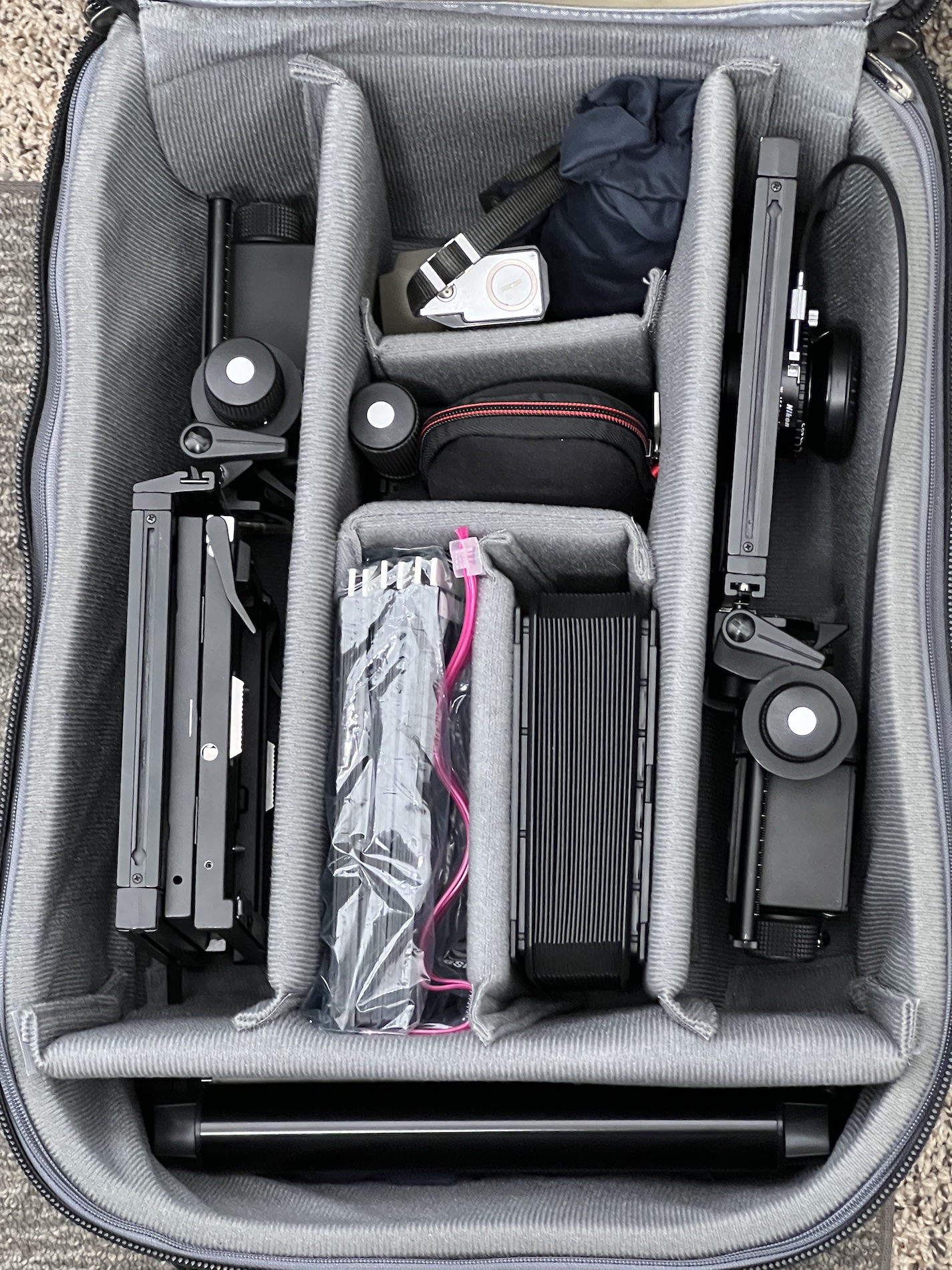

I am looking for a backpack for my F2 as well. At the moment I use my ThinkTank Airport International V2.0, which is not a backpack. The problem I have is that all the photo backpacks are not deeper than 6.5 inches. I was considering an older Lowepro AW Trekker II, but this too is only 6 inches deep. That standards are 8 inches wide. Lately I am watching Ben Horne on youtube, and he uses an Atlas backpack for his 8x10. Like the Atlas Adventure Pack. Perhaps this might be something. Although those are quite expensive.

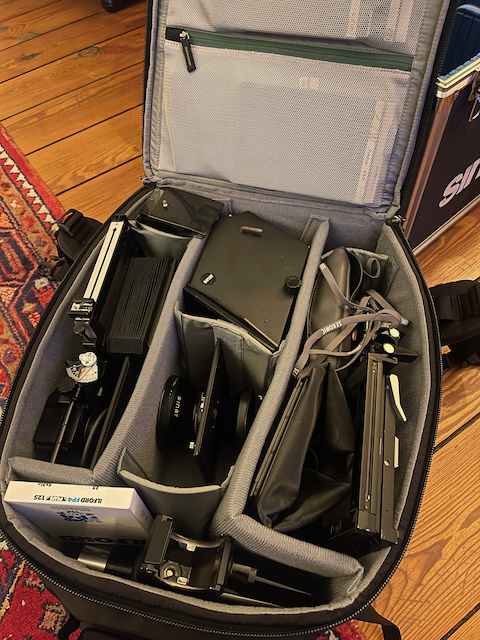

Here it is. What I managed to put inside:
Sinar F both standards with 4x5 back with fresnel
Two bellows - standard and bag
Two lenses with boards
Rail and clamp
Reflex binocular
Lightmeter
Film holders
Couple of film boxes
Tripod with head - strapped to the back
and... there is a lot of space left for small stuff and not so small, as laptop.
It weights a lot, but there is very comfy wearing support.

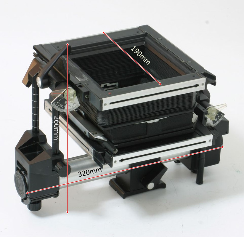

Neil Poulsen
May 28, 2005
525
Take a look at the thread I started below. With a minor customization to a 6" rail extension, one can collapse a Sinar F into a compact package that can be easily stowed in a backpack. In particular, open the images in the first post.
