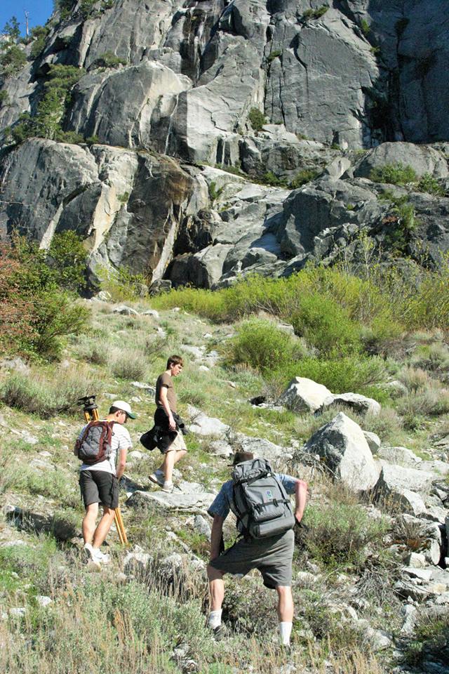

I have been using mine hard for 25 years (including once as check-in baggage). The detatchable daypack holds five 8x10 holders, saving room inside the pack for camera, lenses, meter and darkcloth...and a couple more holders if needed. Notebook and misc in the pocket of the daypack. Has fold-out side pockets big enough for two waterbottles, food, and other non-photo items for the day. A very comfortable pack on the back. I usually have about 45 pounds in it.
After 25 years, the zipper that holds the detachable daypack onto the main pack has failed (my fault, also). I've never used it as a daypack, so I'll remove the shoulder straps, etc and sew it onto the pack permanently. The daypack is also held on by two straps, so one would never lose it in the field (see photo).
A photo of me with the pack on my back -- one of my boys slepping the tripod as we climb towards a Yosemite Valley wall.

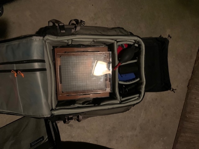

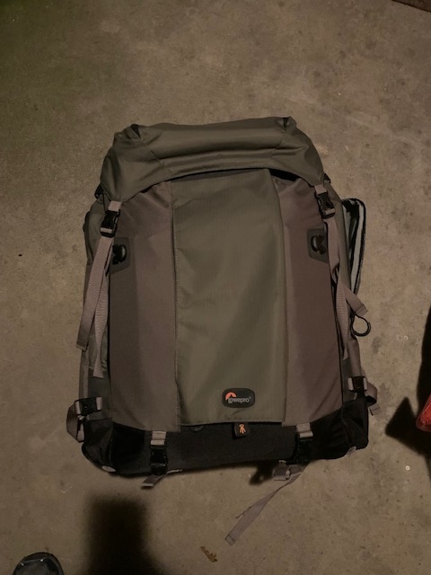

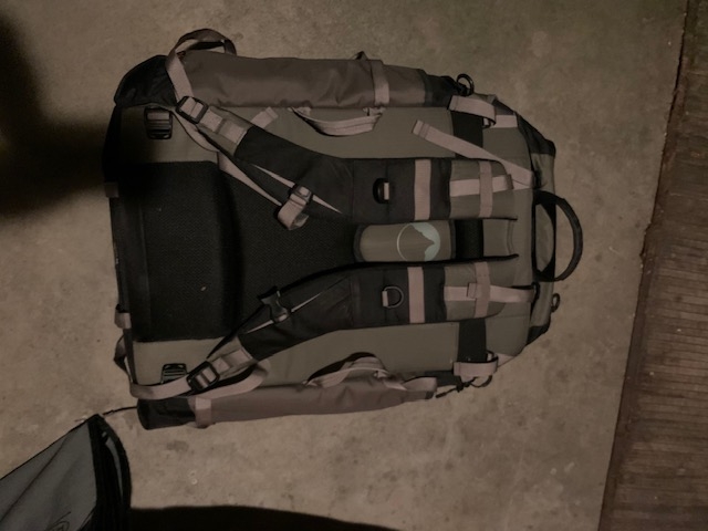

Here are some pics of my current setup; Lowepro pro Trekker 600 AW. With missing waist belt which helps a lot.

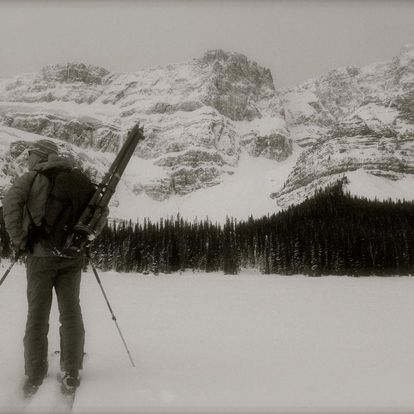

Just wondering if anyone can recommend a easy to buy backpack that will fit an 8 x 10 field camera and a couple of film holders. There are a few that look promising at B&H but would prefer to go with the recommendation of a LF user.
Mark, I'll give you another point of view. I've been a professional mountain climbing and ski guide for 0ver 35 years. I know Drew loves external frame backpacks but they went out of general use in the mid-70s. Decades of great internal frame packs have been used in technical terrain. They're pretty light, well-constructed and carry extremely well. If you look at the Kelty pack, you'll notice the large empty space at the bottom, designed to attach a sleeping bag.....which means the load above puts the weight up high. You don't necessarily have to buy a purpose-made & expensive photo pack. All the major pack makers make bags big enough for an 8x10 kit....for about $250. (https://www.blackdiamondequipment.com/en_US/product/mission-55/also available in 75 litre).
The photo shows just a short trip otherwise i'd attach the tripod horizontally. The pack carried my 8x10 Deardorff kit.
