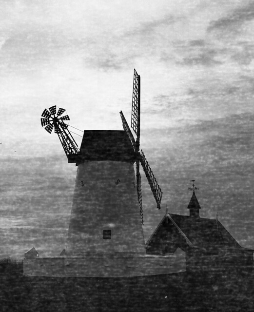

A bad case indeed: HP5+ dated Expiry 2001
Harvey 777 Lytham Windmill Lancashire UK
Strangely it made Explore on Flickr with 9,000 plus views !!
I don't think you would have gotten such a nice picture with good film. I like it just the way it is. Very nice!
