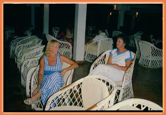

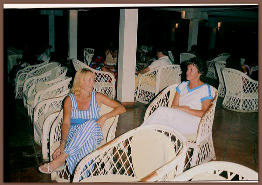

If shooting color negative, the bigger issue is simply "what software to convert negative scan to positive image with GOOD color balance?"
My scanner software has its own negative-to-positive conversion capability, and I have found that it results in a better image, than scanning the negative (without conversion) and then using postprocessing software's negative-to-positive conversion!
Negative scanned w/o conversion by scanner software
'best' possible conversion using postprocessing software capability
Converted negative using scanner negative-scanning capability
Yes, I know the images are mirrored...it was an experiment and I didn't bother scanning the negative oriented correctly, when I was experimenting with postprocess 'invert' (during a separate scan session from the negative scanned by negative scanning software.)
This depends a lot on one's aptitude in using post processing / photo editing tools. Given e.g. your first example, it takes very little time adjusting some curves to get close to the second example.

What scanner and scanner software did you use?
  • I used a Canon 8800F scanner, with the MP Navigator software that Canon provided, to scan the negative as as if scanning a color transparency ('positive') (mimicing shooting the neg with a dSLR). T hen I used Paint Shop Pro's 'invert' function to reverse the scanned negative image, to create the positive image, with resulting very severe color imbalance (very bluish tint to entire photo). The posted photo (with modest residual blue tint) was the best that could be achieved, in altering Exposure, Contrast, and color balance etc. (blue tinted wood floors evident!)
  • For the good photo (3rd image) which I posted in the same thread, I told MP Navigator to scan a Negative, so the software created the Positive image with fundamentally good Exposure, Contrast, and Color autmatically, with no further adjustment by me.
  • Based upon past discussions on photography forums, I know there are programs that do a good job of color reversal of color negative shots with dSLRs. But given the failure of Paint Shop Pro to do the task adequately with its Invert function (above narrative), I wanted to provide the same fundamental caution to OP in response to OPs inquiry (about optimization of the negative for digital reversal to Positive image). After all, no point in worrying about contrast optimization if you cannot get a fundamentally good Positive image after scanning a negative first!

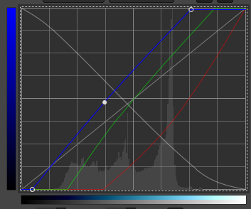

ADjustments on the 'bad'color image:
Result:
Editing time ca. 2 minutes in GIMP

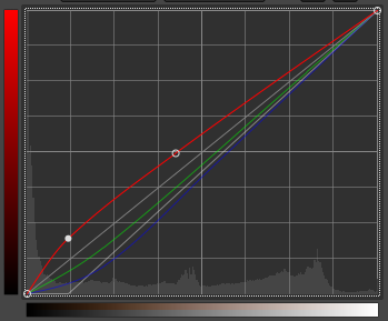

From the negative scan:
Result:
Also about 2 minutes.
No other adjustments done than the curves shown above.
I'm not a PS wizard or anything; all I did was go through the three color channels, pulled the center, bottom and/or top a bit, and iterated between the three channels until I called it good.
This is just a quick & dirty illustration that it's not inherently more difficult to do it one way or another. It really all depends on personal preferences and whatever you find that works. I'd be very hesitant to try and convert this into some 'generic' advice since it's so personal. It's also not the case that one piece of software will consistently outperform the other on the same image data acquired by the same hardware.
Result:
Result:
Improved, but I still see blue tint of the wooden (brown) floor located at the feet and white chairs behind the lady in blue stripe dress in the photo. (That same blue tint is not visible (especially on the white chairs) with my third posted photo in that post, in which MP Navigator knew it was imaging a negative and had to create a resulting positive image). So I need to say "Not so" in reply to your statement, "it's not inherently more difficult to do it one way or another."
For anyone wanting to try making a better result, here is the actual file output by the MP Navigator software, in which it (exactly as I told it to do) treated a negative as a color transparency (thatis, to mimic shooting a negative with a dSLR and lens, and then psotprocess the resulting image)
I especially encourage the OP to try his hand at it, as it is a fundamentally required capability, even before worrying about optimization of contast in the negative.
Improved, but I still see blue tint of the wooden (brown) floor located at the feet and behind the ladies in the photo.
I didn't optimize for that in particular. It's a small nudge of the blue curve is all it takes.
