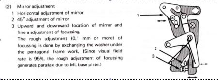

Not sure about RTS II but some other Contax models and Yashica can have their mirrors adjusted as follows:

Interesting mirror adjustment, shown in that manual.
Thus:
Maladjustment of the mirror stop yields an oblique plane of focus.
Focusing onto a target plane in parallel to the film plane will easily show this fault in the finder.
is not valid here, but misalignment actually can lead to parallel focus shift in this case.
