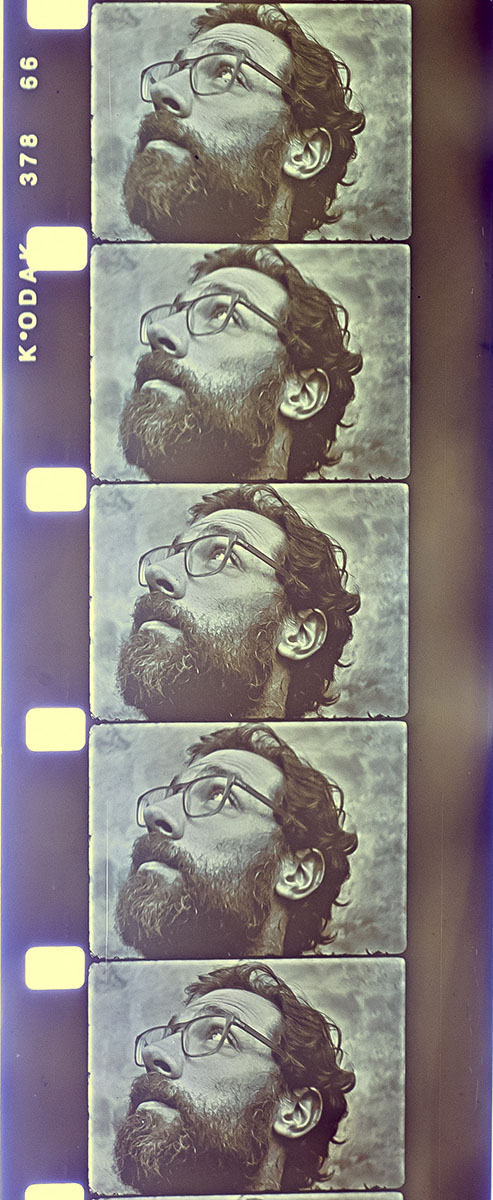

I use Tim Rudman's copper bleach formula, it is slow but works well! This is for one of my first tests using the copper reversal bath.

That's nice! There is a thread on using copper sulfate bleach in B&W reversal processing in case you're interested.
Thanks Raghu, that threat you mention was my starting point, but it misses some big information I think, like time, temperatures and one thing that is important is that copper bleach needs to be aged.
Looking for some information on copper reversal I end reading a lot about holography, that as I can see the copper bleach comes from there.
I post it here because I read in the firsts entries that Donald writes about copper and ferricyanide. Ferricyanide will not work with ammonia as far as I understand, but copper does and very well.
My process is as follows.
Film 16mm 3378E rate as ASA25. Camera runs at 16fps, f5.6 lens 20mm.
1- pre-wash 2min in room temp water
2- 1st developer parodinal 1:25 [500ml] + 10g of sodium sulfite. 12min at room temp [around 26º]
3- wash
4- Tim Rudman copper bleach formula [http://real-photographs.co.uk/.../copper-sulfate-bleach/] 40min at 30ºC
5- cleaning bath
6- re-exposure as always
7- Diluted ammonia bath. I use MrMusculo window cleaner that is 3% ammonia hydroxide solution for 2 hours. Diluted ammonia will dissolve AgCl. Afaik will not touch AgBr that is soluble in concentrated ammonia.
8- wash
9- second developer, same as 1st one for 4min
10- Hardener fixer.
Raghu Kuvempunagar
Jul 28, 2016
3,155
India
@general: Thanks for sharing your experience with copper sulphate bleach. Though not as widely used either dichromate or permanganate bleach, copper sulphate bleach works quite well for reversal processing of B&W film. I have used the bleach on a variety of films and have no complaints about it except its slowness. In fact, for Adox CMS 20ii, it is probably the most reliable bleach as several users have had bad results with dichromate and permanganate bleaches. I reported my process for Adox CMS 20ii with copper sulphate bleach here.
Your process looks good and I've just a couple of questions.
Did you use the full-strength bleach or the 1+9 diluted bleach that Rudman used for bleaching prints?
Did you mean 2 minutes? I use 2% ammonia and never had a need to bathe the bleached film for 2 hours in the ammonia solution! Usually the film clears in 2-3 minutes and on rare occasions I've went up to 5 minutes.
BTW hearty welcome to photrio and it's relatively small 'group' of reversal enthusiasts! I didn't notice that your first post in this thread was in fact your first post on photrio.
General Treegan
Jan 6, 2018
16
Mexico City
Super8
@Raghu Kuvempunagar Thanks for the warm welcome, I've been reading posts here for a long time, never post till now :smile:
I will take a look at your Adox experience, I never use adox film.
About Tim Rudman bleach I use full strength, I make a test at 20min and 30min and the results are not good and at 40min works well.
Ammonia... I say 2 hours yes! I use the window cleaner that it says is 3% and also make testes at 15,30, 60 min and results are not optimal so I leave for 2 hours and the results are as expected. I still need to try an ammonium hydroxide solution, not window cleaner.
