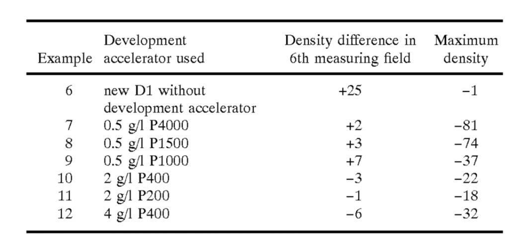

I'm curious if you had tried PEG as an accelerator. I know you showed me an article in the thread I posted but it seem like adding just PEG itself lowers Dmax. Now with the 3rd lockdown in the UK it's going to be hard to get access to the lab to get my hands on some PEGs. My plan now is to just clip off film leaders for TMax400 and try it with the 1.3x Microphen I have but adding different percentage of sodium thiosulfate or PEG or a combination of both. I would be interested to know if you know a PEG percentage to start experimenting with.
Here's the Agfa patent for the first developer: https://patentimages.storage.googleapis.com/f7/bd/9d/6a0a4f9307d9d8/US6350563.pdf
I read through it and this is the relevant chart:
But from reading it, it does not sound like adding the PEG alone is enough:
"Surprisingly, it has now been found that the use of 5-methylbenzotriazole in combination with polyglycol P400 and hydroquinoneSulphonic acid resulted in the desired gradation curve and in usable image results."
Regarding what that means:
"P200 and P400 resulted in the lowest loss of maximum density, so that P200 and P400 appeared to be the most suitable for this developer. All further investigations were therefore performed using P400 as the development acelerator.
You're reading the wrong parts.
You want the 'Commercially Available First Developer Containing Hydroquinone' recipe. Ignore the HQMS ones derived off E-6.
The rest is much like all those peroxide bleach patents, where they are defensively patenting research that while it may never have worked well enough for commercialisation, it protected research paths that might be productive in the future. Thus, while the bleaches might not be much realistic use, the disclosed developer recipes for RA-4 and C-41 are of interest - as are the layer structures of C-41 films. It's the same with Ilford patents that disclose the recipe for 'Multigrade' developer alongside other work which never made it to commercial fruition.
