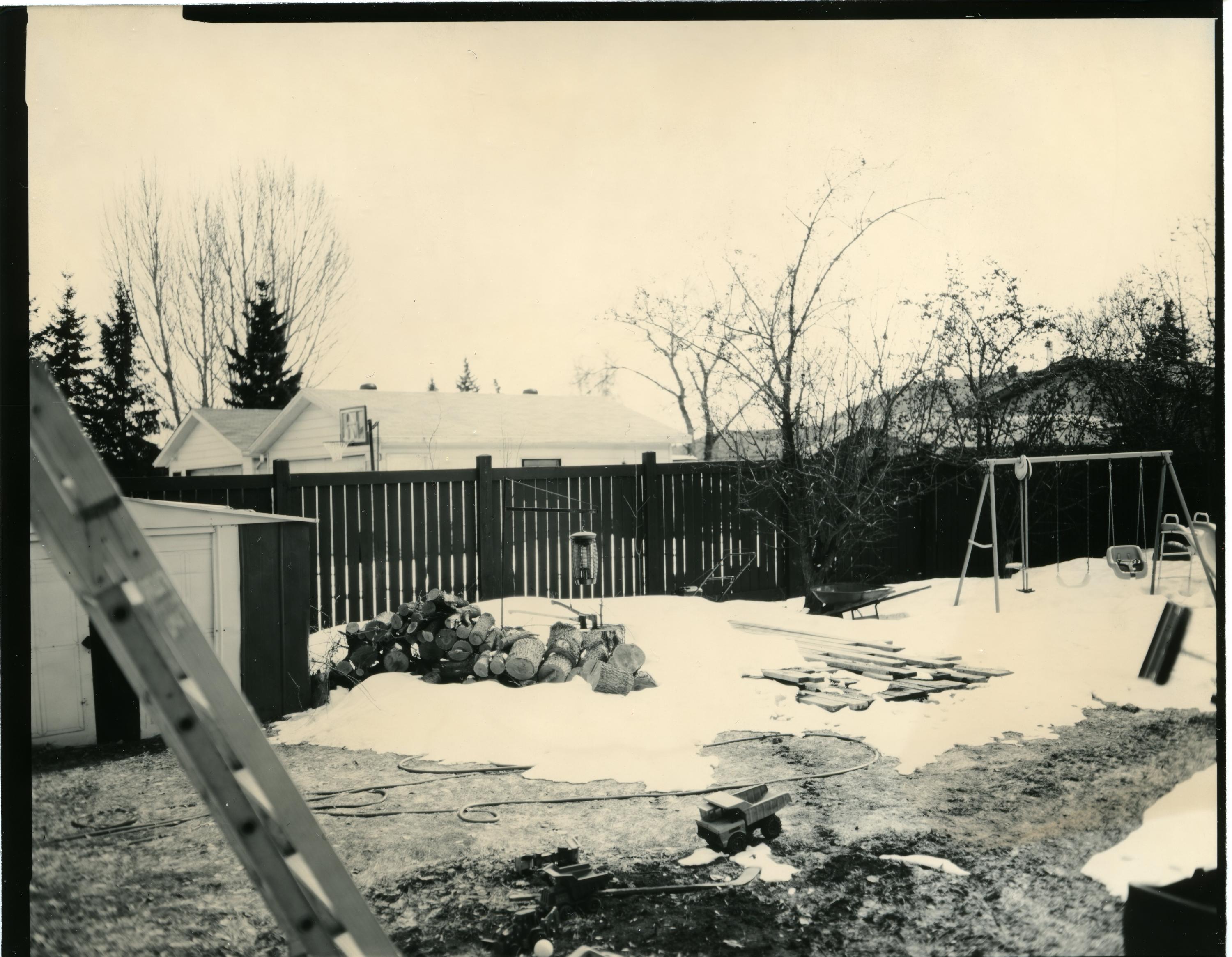

I hope someone can guide me in the right direction on this. I am no chemist. I'm getting nice results, but I have an overall brown tan to my highlights. Not getting any whites. Is this possibly a result of over-development in the 1st developer? Result of a bit of hypo in the developer?
It doesn't appear until the second development. Is this due to my bleach? The purple stain of my bleach does magically vanish in my clearing solution.

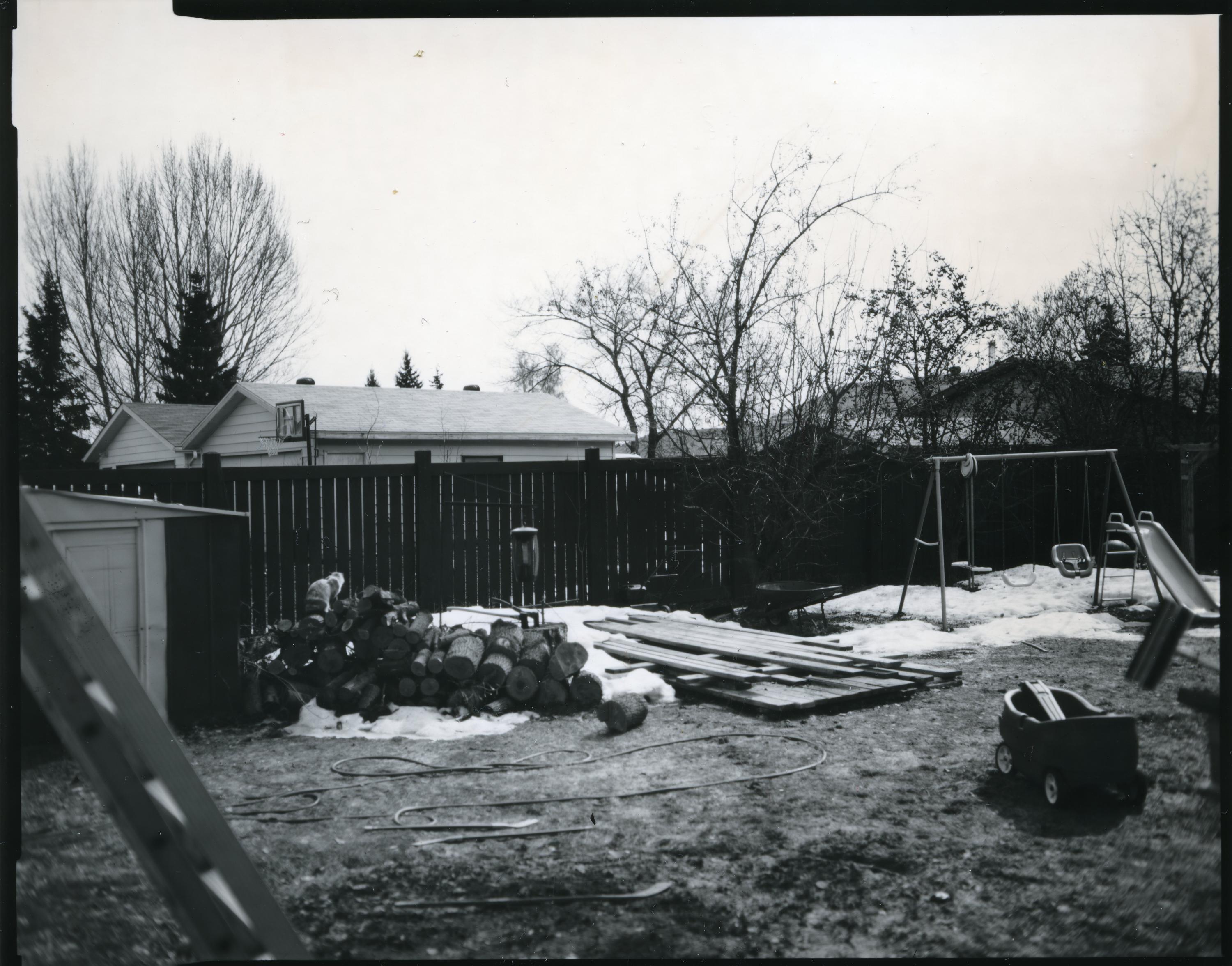

But I did some more experimenting and dropped first developer time and found when I drop down to 1 minute, it's looking white.
Here I have taken the 1st development to 1 minute, and the 2nd development to 20 - 30 seconds. It was taken to completion.
Hello Wayne: That looks better. I guess I was trying to apply my experience with film reversal to paper. Given this result, reducing the developers times could solve the problem. I have a question regarding this process. Since you are using Multi Grade paper would you be able to alter the contrast by placing variable contrast printing filters in front of the lens to change the contrast of the final image?
Doug:smile:
Contrast filters should work fine. Though you do have to take into account exposure compensation. Which is simple enough. I think published data out there for the filters themselves should tell you exactly by how much to avoid having to experiment much.

I actually prefer the tones of the first picture = it's gives you something different from the norm that you seem to be aiming for ie white hightlights. Each to their own I suppose. :smile:

I know this is besides the point, but I like the first toned one better too.
