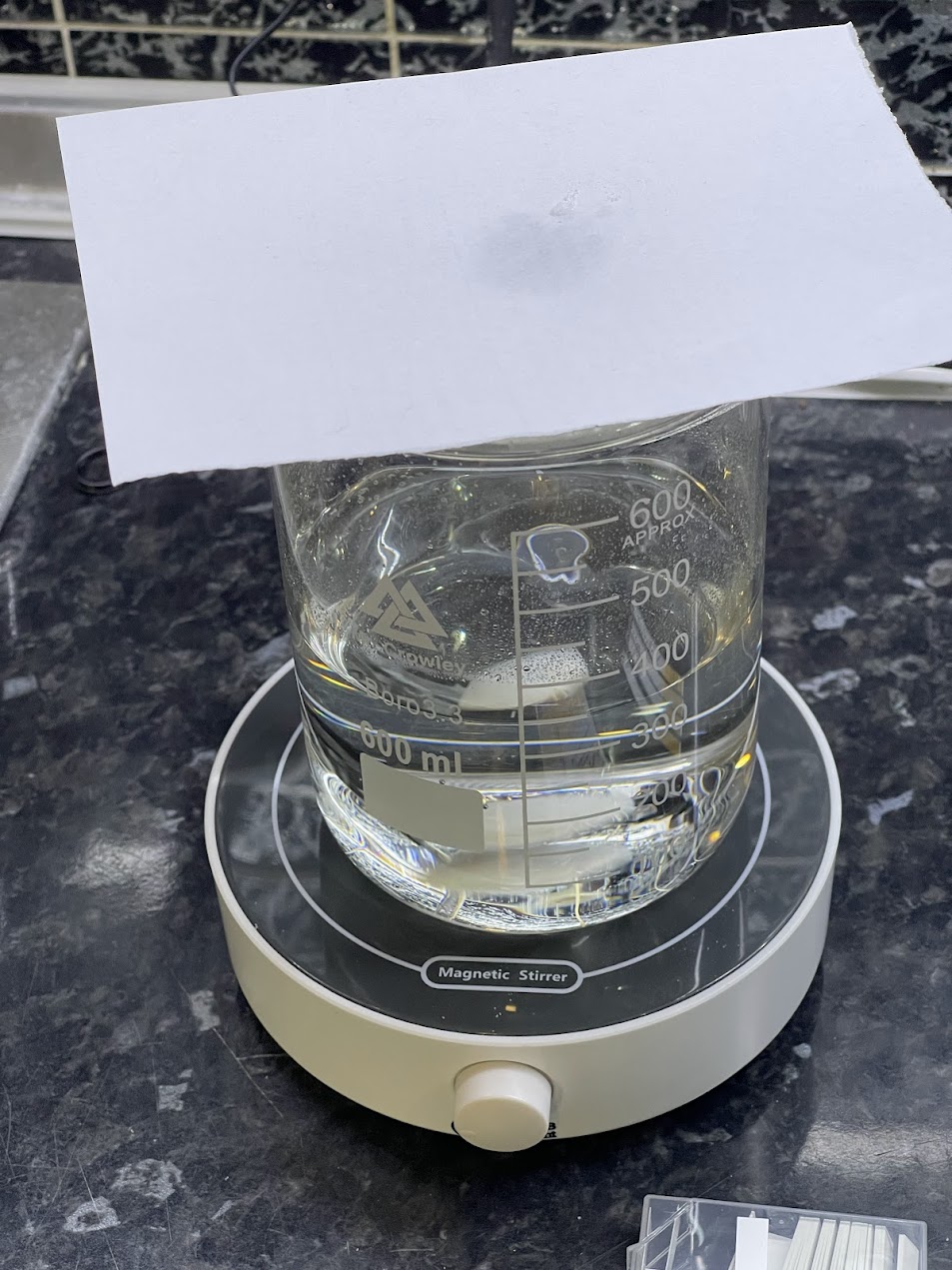

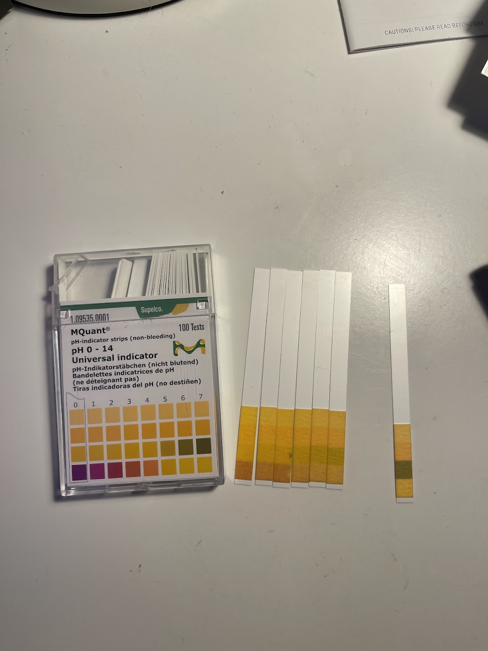

Hey again.
Today i tried again with pure sodium bicarbonate and PH strips. I was using automatic stirring in this and previous attempts. I added peroxide, EDTA-4Na, stirred for a minute, added sodium bicarbonate, observed bubbling, stirred for about 5 mins and proceeded with the citric acid.
I started with 5g of citric acid (rightmost strip) that yielded 6+ph. Then i added 6 more up to recommended 11g of citric acid and got a strip very close to ph 5.
Then I iteratively added 2g, stirred, measured and tested effectiveness. I slowly reached ph 4 at total of 19g, but it still didn't work. Then i stopped.
I can see three possible answers:
* EDTA-4Na option has some unforseen complications and doesn't work that easily
* My peroxide is crappy. I don't have easy way to test it and finding peroxide test strips isn't that easy
* I'm mixing and stirring in fundamentally wrong way somehow, because i'm definetly not a chemist
Next i'll wait for pure EDTA to arrive and try with it. If it fails too, i'm blaming peroxide. Probably i'll order from another supplier, or just buy one from pharmacy...

Does your automatic stirrer heat the peroxide? It may be breaking it down. One simple test for peroxide is to find some zinc and add it to a small amount. Note that this is destructive. A _galvanized_ nail or similar should work. Be sure it’s zinc. If you don’t get bubbling on the surface of the zinc within a short time, the peroxide is probably bad. That won’t tell you very well how strong it is, but it will tell you If it’s pretty exhausted.
artyfarty
Aug 11, 2023
9
Antalya
Stirrer does not heat, the beaker is way below body temperature.
But getting well over 30 degrees while in shipping in this climate is quite common, and we are almost in June, soon even the air in shadow will be close to 40.
I'll try the zinc trick.
