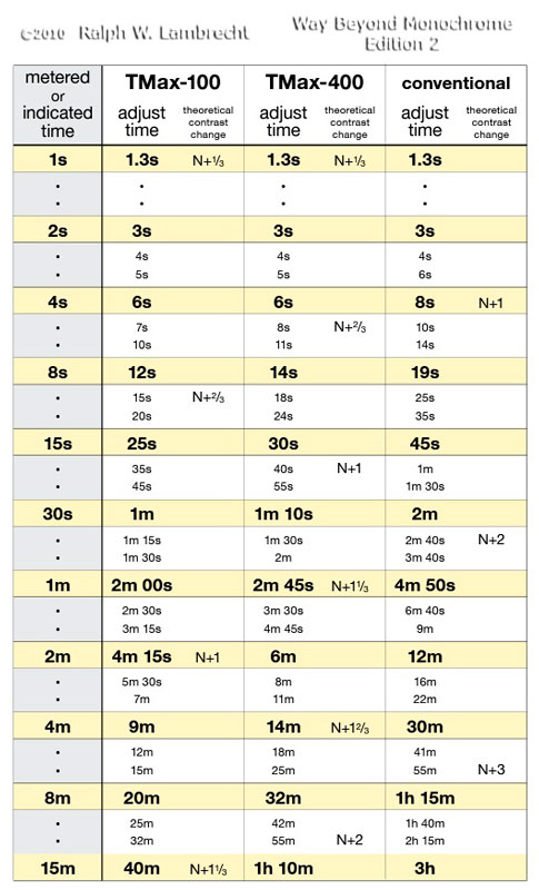

As others have said already, reciprocity failure is best compensated through an adjustment in exposure time. Extending the exposure has an affect on contrast, but as Neil said, it's easy to compensate for that during printing, if you use VC papers.
I also like to offer the attached reciprocity table, which is based on data I received from Howard Bond and John Sexton, as well as my own tests.
Feel free to check my website for the pdf version of this file and more exposure aids and pinhole photography tools.
Dead Link Removed

Ralph,
Does 'conventional' mean any 'non-tabular' grain film, such as FP4+ and Tri-X?
- Thomas

Ralph,
Would these hold true for Delta 100 & 400? My experience with up to 3sec has been that no adjustment was necessary after comparing the same subject taken with none and with adjusting. Both presented no difficulty printing albeit on Ilford multigrade fb using an Aristo 4500mc lamp.
Jeff
Ralph,
Jeff
Yes, they will, but I can mirror your experience.
