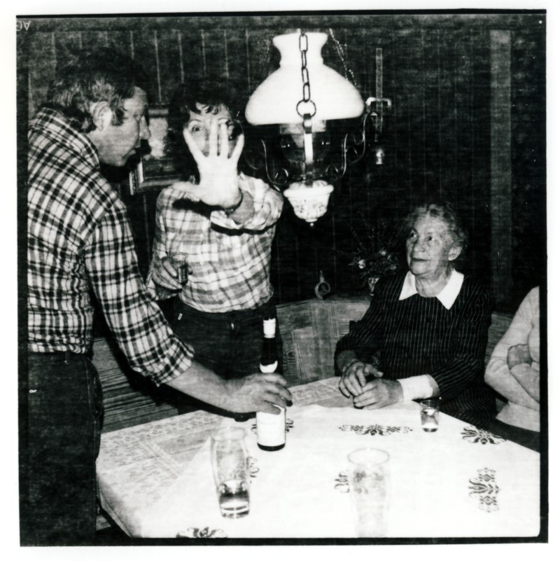

I have found old film in agfa isolette that I bought - I think film was minimum 20-30 years old: it developed without any problem (see attach). Some base fog because I used Rodinal semistand method, but if I had used HC110 dilution B - I belive it would be even better.
