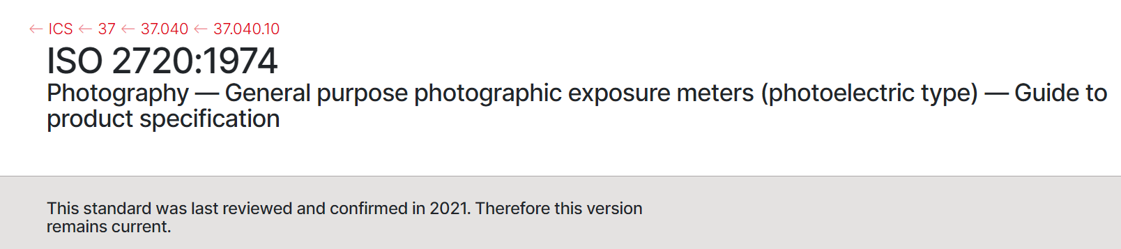

Do you mean these?
ISO 2721:2013 Photography — Film-based cameras — Automatic controls of exposure
ISO 2720:1974 Photography — General purpose photographic exposure meters (photoelectric type) — Guide to product specification

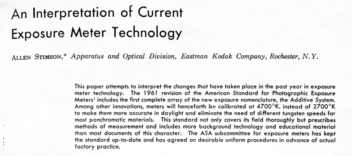

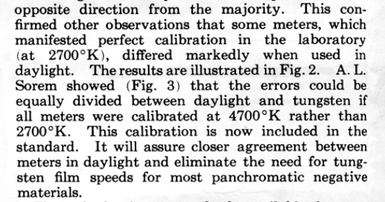

An Interpretation of Current Exposure Meter Technology which ic-racer referred to in an earlier post answers the question as to the color temperature change in the calibration light source.
For panchromatic film the difference is about 1/3 to 1/2 stop.
Thanks Stephen. I'm sure I've read this before but without appreciating the significance of the change in calibration light source. Which, according to the graph you just posted, helped to balance the "color temperature errors" between two classes of then-existing exposure meters - those that were substantially red-sensitive vs blue-sensitive.
