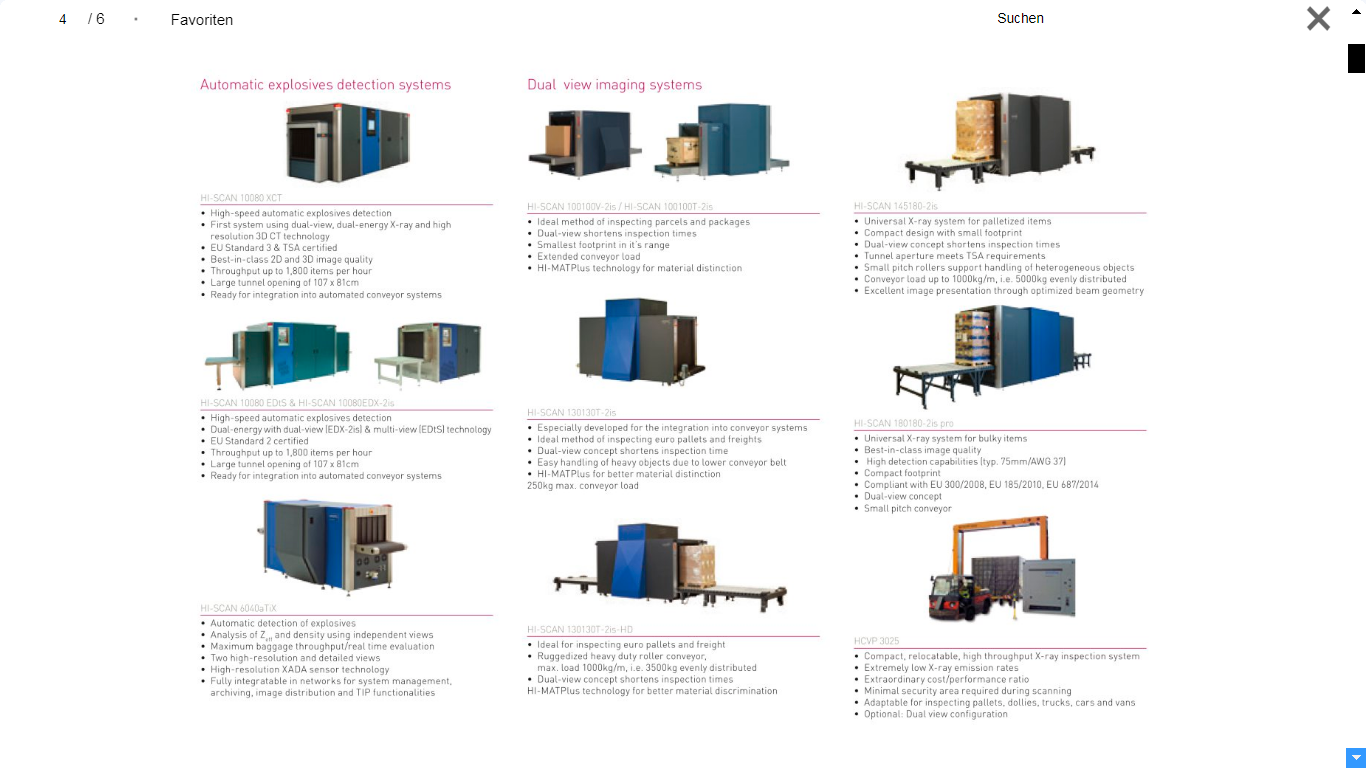

Concerning the outer shape, this is a misconception. Concerning those installed by now at passenger gates there is at least one model that does not look like this. (This by now is the 3rd time I hint at this.)
And concerning quite some baggage, parcels scanners in general I am not able to distinguish them just by photos in catalogs, I need the "CT" hint in their designation or respective information at the text.
From the list in #19 only the Smiths CTIX is a little harder to recognize, but even that has a clearly larger bulk in the center section that houses the torus device, setting it apart from the generally far less bulky xray scanners. Still, of course outward appearance is only an indication and in itself gives no guarantees as to the contents of the device. However, speaking of a misconception is not appropriate in my opinion. Then again, anyone is free to choose their own words.
Misconception so far as that for an uninitiated (esp. under his restricted view) the scanners are basically to be distinguished by the characteristic look. In München for instance there was set up a CT scanner of "typical" spindle-look next to a CT one in box shape.
But as a proof here an assembly of scanners. Only one of them is a CT scanner. Koraks, I shall give you realistic 10sec to find out.
But I am sure you would no succeed in 10min without reading the text...
All from Smiths, including the top left CT scanner, which I noted in my post was the one brand on the list that I asserted was more of a box shape resembling the old-fashioned scanners.
Btw, the specific product you linked to seems to be primarily intended for use as a checked baggage scanner, not a carry-on scanner, given its integration into automated conveyer systems. So it's not the kind of scanner you'd expect to find in the public area of an airport terminal.
-) the one CT scanner is not even that one used these days at passenger controls, which is even more box-like
-) that parcel or freight scanners look more box-like will not keep manufacturers from making passenger-control ones look the same
-) part of our shipped films will go through these freight scanners too. It thus is important to realize that they practically are not to be distinguished if one should gain a glance at such.
(And otherwise the scanner being of the stronger plain version would spoil film too...)
