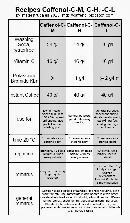

I use Fomapan 100 and I like it. It's cheaper too.
I also develop it with Caffenol-C-M and got very good results.
attachment.php
(source: http://caffenol.blogspot.nl)
