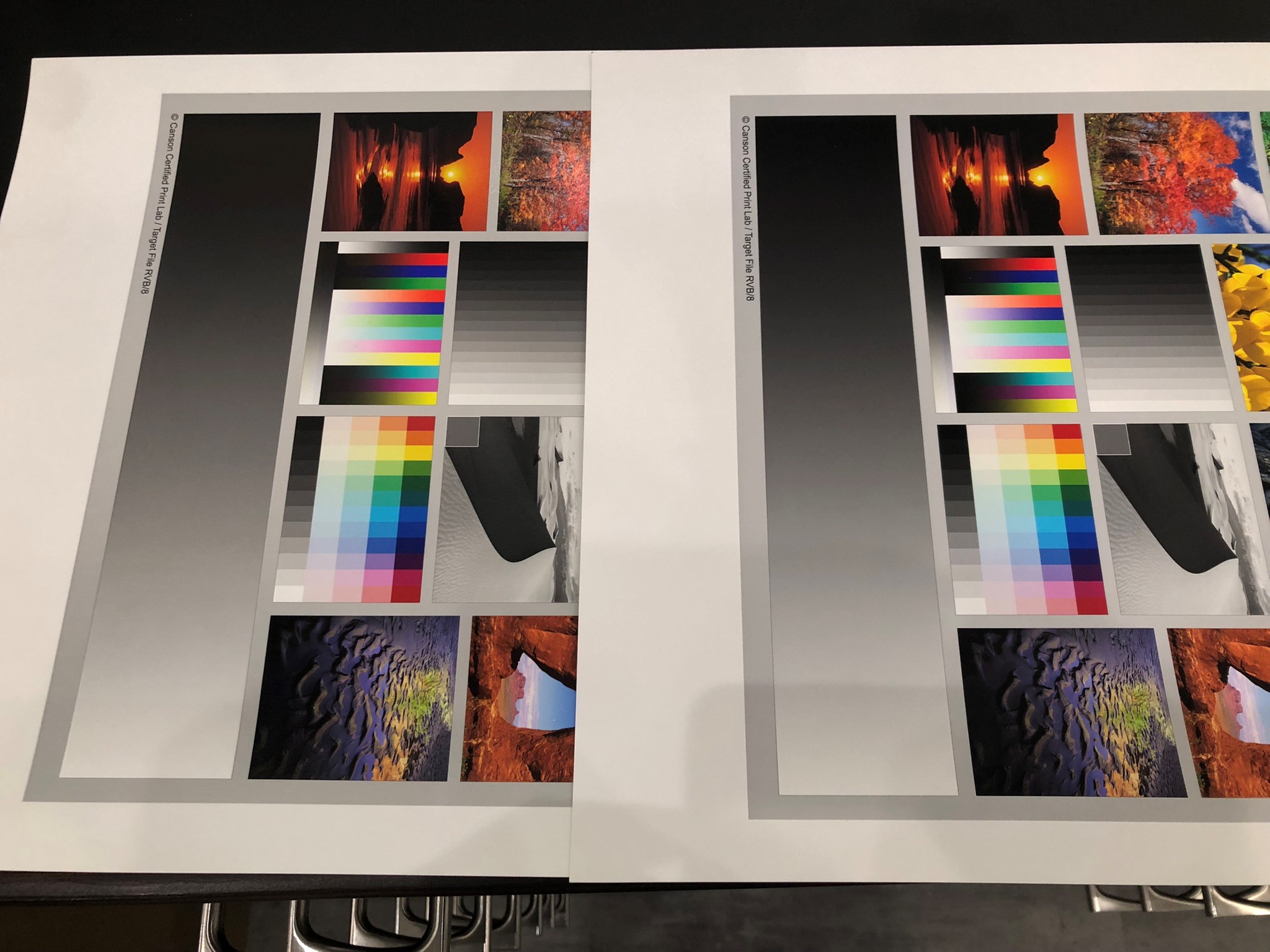

I would take your digital file and try it on another printer such as the Canon Pro-10. I switch from Epson to Canon and found I much prefer the Canon prints.
