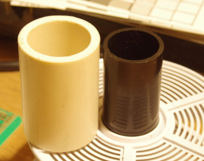

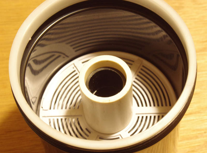

For the earlier Paterson System 4 tanks, (pre 1980), Paterson supplied a locking collar which is fitted to the centre column after the reel has been slid onto it. The purpose is to prevent the reel sliding up during inversion agitation. For the newer Super System 4 tanks and reels a locking collar is not supplied as it is supposedly not required. To make doubly sure, if you are not confident, you could twist a rubber band onto the centre column after sliding the reel on and snug it down against the reel. This should hold the reel at the bottom of the column. Another way is to place additional reels on the column above the loaded reel, either empty or, if processing more than one film at a time, loaded with film.
Here's another way to prevent the reel from slipping up the centre column:
Cut a piece of one-inch diameter PVC pipe to 49 mm long, and you'll be certain the reel won't slip upward.
Mark Overton
tokam
Nov 7, 2008
589
Sydney, Aust
Mark Overton
Nice one Mark. I had a similar idea to cut the bottom off of a 35mm film tub supplied by Kodak, Fuji, Ilford et al. This would give me a tube of around 47mm long to act as a spacer in the dev tank.
