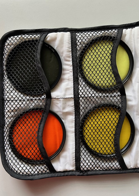

The two on the right are B+W light yellow 021 and dark yellow 023. The lower left is Heliopan Orange.

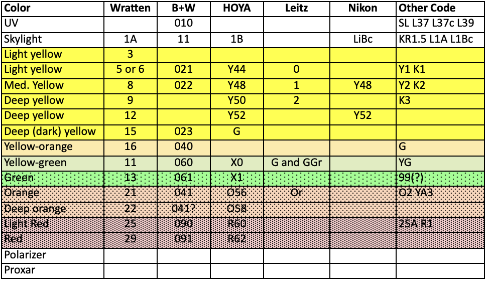

Hi Everyone,
Awhile ago, I got so frustrated with the different nomenclature that different filter companies used in labeling filters for black and white work, I made a comparative list. These are the ones I have used. I am sure there are other companies with their own terms that I missed. I hope this helps.

You might post that in its own thread, with a thread title like "Comparative filter designations". Others could then post other, similar resources, and we could consider making the thread a Sticky.
DREW WILEY
Jul 14, 2011
13,879
8x10 Format
That's just the tip of the iceberg, and a rather old rendition of it, and in fact, downright inaccurate in numerous places on the chart. And even similar designations between brands doesn't mean they are identical. Even the same brands tended to shift over time as the filter manufacturing options themselves evolved. I sure have a pile of the damn things; yet every one of them has its own distinct niche in terms of relevant application.
I'm sure I'll stir up a hornet's nest, but there is a real functional distinction between a 22 deep orange filter and a light red 23A, especially with respect to green response, that is, foliage greens which actually reflect quite a bit of red light too. Then with color films, a 1A, 1B, and KR1.5 "skylight" filters (the KR1.5 is actually a "light balancing"
filter) - all have practical distinctions when it comes to differences between specific films, atmospheric circumstances, specific hues, etc. For example, I need one type at high altitude for typical Ektachromes, another variety for Fujichrome, and yet another for Ektar color neg film. Frankly, I'm glad there's so much variety.
This additional information should include Neutral Density filters from various makers/brands, IMO, simply because the Filter Factors or F-Stops.
For example, many ND filters are marketed in stops, but others are F.F.
Hoya is one maker I have and the two ND filters I have are marked simply 2 and 4, whereas my Written gel ND filters are marked in F.S..
