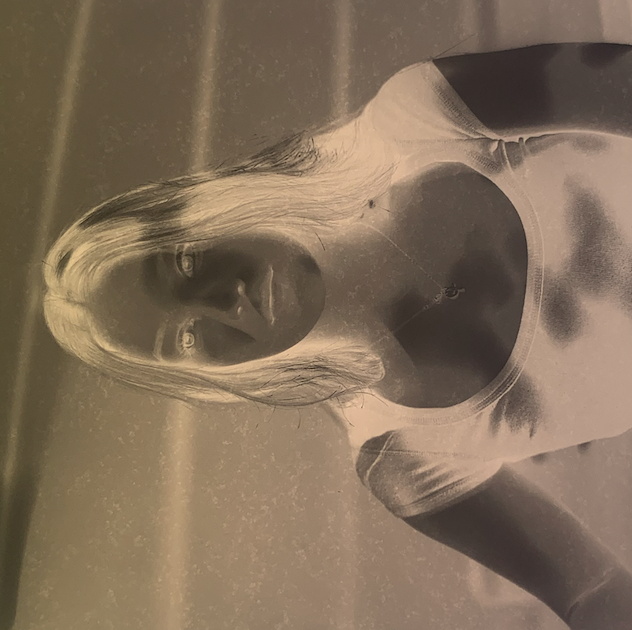

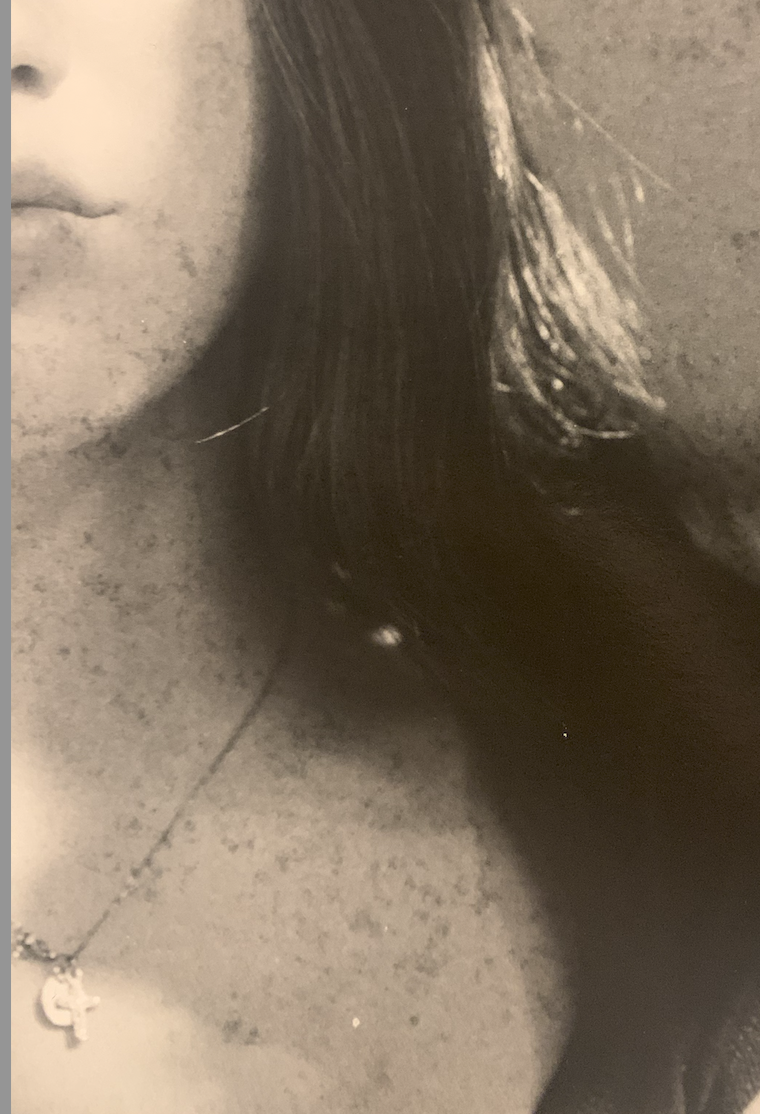

Hi,
I am new to this forum but I have been practicing for 20 years without a lot of problems in ZebraLab in Geneva.
I have develop a medium format FOMA 100 with Ifosol 3 at 20 degrees. I pre-washed, develop, stop, fixed (without temp control) and wash.
The results are awful as I have this huge grains that make the images useless. You'll notice that it's only visible in dark areas.
If anyone know what causes this, I am very curious. Thanks a lot!
Best,
Jean Luc Andrianasolo

If this is a medium format film, then this mottling (it's irregular and uneven, so it's not a grain) most likely caused by the backing paper - Foma is not exactly good at quality control.
Welcome to Photrio. Soon more proficient individuals are going to chime in.

What M-88 said (apart from the quality control bit). How was the film stored?

I agree with the others that this looks like backing paper mottling. The following factors can influence this:
  • Unpacking the film while it is much colder than the ambient temperature (causing condensation), for instance right after taking it from a fridge/freezer, or film that has been brought from outside and immediately opened.
  • Long-term storage of the film under adverse conditions, e.g. high temperatures.
  • Freezing film if it has been packaged under conditions of abnormally high humidity, causing crystallization
The above can be amplified if the film is old/expired, since it will then have had more time/opportunity to be subjected to any or all of the above.
Can you tell us a little more about this particular roll of film - how old is it, where did it came from, and has it gone through large temperature and/or humidity swings to the best of your knowledge?
If the film is fresh and within its expiration date, and it was handled properly, you could reach out to Foma to ask if they have any suggestions. I've done this once, years ago, and found them to be responsive and straightforward to deal with.
I have used quite a bit of Fomapan 100, also in 120 format, and have never seen this issue on this particular film. I am familiar with backing paper offset problems and this sure looks like it.
